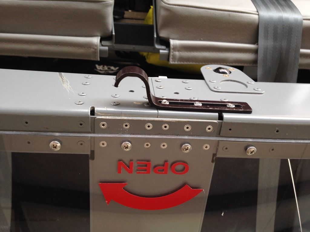

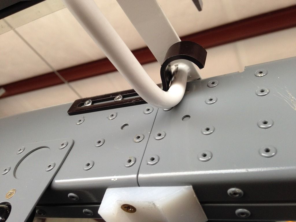

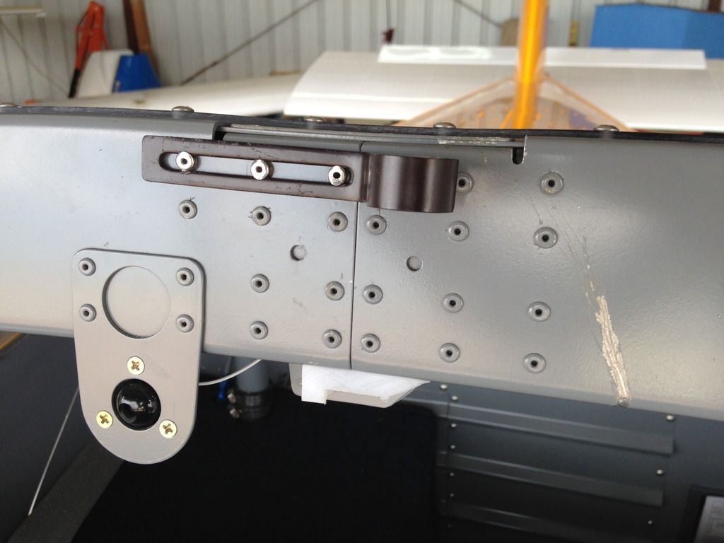

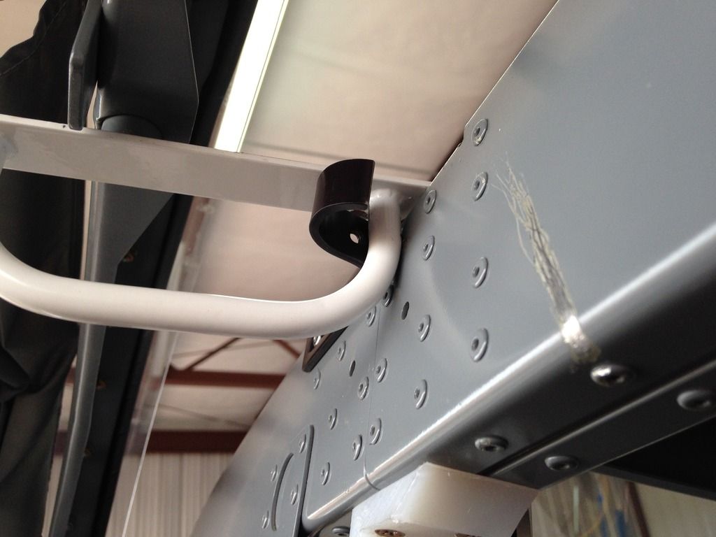

This is solution 101 based upon Mich48041's concept. I found that his idea needed modified since the socket for the handle in the canopy front would hit his angle. Solution is to curve the bracket to miss the socket and provide a "catch pocket" for the handle. I just drilled out the top three rivets left of the rollbar seam and used 3, 4-6 pulled rivets for a first install. If satisfied I may replace with larger structural rivets or thread for bolts. I just modified a curtain rod support bracket for this. Seems to work well. Hopefully this pictures will explain it all.

Scott, your speed and creativity in fabricating this is amazing. Looks like a reasonable solution.
