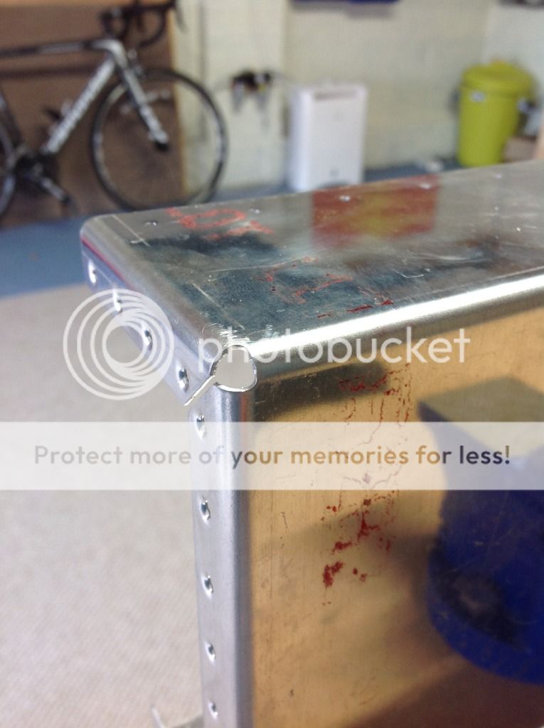

Having just started on my toolbox kit I wondered what the best tool is to deburr those hard to reach areas, so far in my toolbox i have 3 different scotchbrite wheels, hand pads, vixen file but nothing to tackle the smaller jobs such as this, is this the time for a Dremmel purchase!

Get a roll of cloth backed sand paper and tear it into strips about 1/4" wide and 6" long. I have a small round and flat file I use to break the edges before I sand. Have fun. When deburring the wing ribs you will think there is no end.

Set of mini files. Set has all different shapes.

I used this type of deburring tool on the inside corner
http://www.browntool.com/Listview/ta...0/Default.aspx
Followed by this 3M Mini Mandrel
http://www.cleavelandtool.com/3M-Min.../#.V3seLvkrKUk

These "cartridge rolls" mounted in a dremel or air powered rotary pencil work really nicely. They are commonly used for mold polishing and 2-stroke porting work.
McMaster catalog page of "cartridge rolls"
Scroll down the page to where it shows the spiral wound tapered rolls and shank adapter. That is what I am trying to share.
Fine grit is best for our application.
Try 4688A631 cartridge and 4690A21 arbor

I used a dremmel tool too.
But I've cut small squares of 3M (maroon) scotchbrite and pushed the screw the the middle of the square and into the mandrel of the Dremmel.
You tend to blow through the squares fairly quickly...but it works well and its cheap!!!
