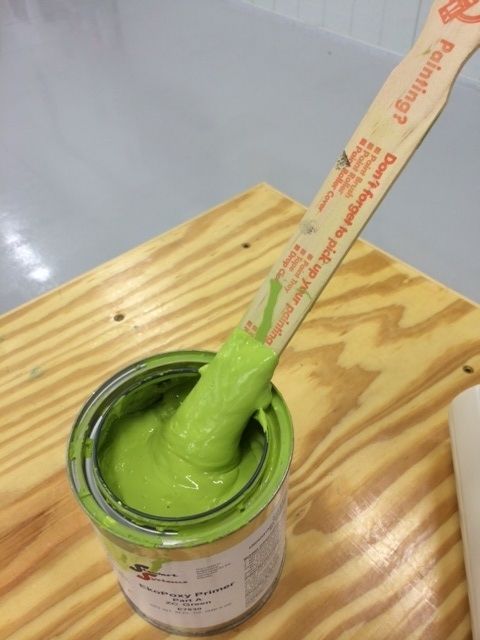

I thought I'd give Stewart Systems EkoPoxy primer a try. This evening I got all set up to spray and opened the first can (part A). The consistency of part A is what I would call extremely thick. It's roughly that of window glazing or maybe comparable to canned dog or cat food. In fact, as I write this from my shop, the stirring stick is still standing straight up in the middle of the can.
For those of you who have used EkoPoxy primer, can you tell me if this is normal? If so, how do you measure part A. Also, if this is the norm, how do you get it out of the can...perhaps a spoon?

I had a similar experience with EkoPoxy, Fred. This happened last September. I could not get the Part A to come to anything smoother than "chunky", but decided to add Part B and the recommended dose of water to see if that would help. Then I mixed it like crazy and when I thought it was good enough, put it through a paint strainer then into the gun. I had to force it through the paint strainer with a tongue depressor as it was still lumpy.
This mixture sprayed very poorly. I could put on a fine mist, but as soon as the droplets started to coalesce it would sag and run, while still having so little coverage that I could clearly see the substrate. Very disappointing. Everything I sprayed on had to be sanded off; once this stuff dries it is like epoxy, hard as nails, so sanding it off is hard work.
With this in mind, I called up Stewarts and talked to Dan. He immediately indicated the product was faulty and offered to replace it without hesitation (and without me having to even suggest it). The new EkoPoxy was a totally different beast - it came out of the can easily, mixed easily, and sprayed well. Oh, it, too, is hard as nails. Very impressive stuff once its dried.
As far as recommendations go, I would first look at the date code of your product - if it is getting close to a year old and hasn't been stirred regularly then you may need to stir it quite a bit to get it to break up. The recommendation for this product when it is being stored is for it to be agitated on a monthly basis.
When in doubt, call Stewarts. In my case, they had a product problem and couldn't have been better about making it right. Top notch customer service. Now the EkoPoxy has been on our airplane for a few months I have to say I'm glad it's on there because I know the airplane underneath that primer is well protected. Next month I'll be applying the EkoCrylic top coat.

C. Joy, your story sounds like an exact copy of what I did this evening. I was using a new primer gun (3M Acccuspray) so I was spraying a practice kit just to try out the new primer and gun. I should know better than to change two variables at once.
I too took a "chunk" of the primer and decided to mix it based on weight rather than volume. The directions are on the side of the can doing this. My experience was the same as yours in that it wouldn't even go though the screen at the recommended mix.! Since this was "experimental", I decided to reduce the primer significantly. Using distilled water, I thinned the paint to a point where my "gut" told me I was good to go. The results were similar to yours although some of the parts came out very well.
On a bright note, to those reading this, the 3M Accuspray is one of the best purchases I've made in quite a while. It actually tried to spray this stuff and some of the pieces are even acceptable/good. Clean-up was under 3 minutes and worked just like the video on You-Tube.
I'll give Stewart Systems a call on Tuesday as this can is only 45 days old. I really liked the lack of fumes and the water clean-up. I'm going to try Ekopoxy again after speaking with them.

I had the exact same issue with a can I ordered in January from Spruce.
Stirrer would just get 'stuck' in the actual paint. Mixed it as recommended, it however still had (at least) a honey like consistency. Tried to spray it anyway with the 3M Accuspray gun, even though I knew from spraying other paints that this will not work, only to learn that this was indeed the case.
I then ordered another can directly from Stewart, which was MUCH better. Mixed it again as recommended, this time with OK results. I however still thought that it the paint is a litte bit thick, so added more water and am now happy with the results.
I also called Andy from Stewart, who was very friendly and offered to replace the old can. As I would have had to ship it back on my expenses, I decided to simply add water until the consistency was similar to the new can, what worked fine.
By the way - I bought a postal scale and weighed the individual components based on the volumetric ratio (5:1:1 + the water I decided to add). This allows me to also precisely and consistently mix smaller quantities.

Sounds like the result of improper storage to me (not necessarily on your part, possibly upstream). I bought a gallon of EkoPoxy for my fuselage, figuring I might just use it as a topcoat in the interior. The first weekend after it came in, I cracked open the can, mixed up a small batch, and shot some test batches. It mixed up nicely, sprayed great, and in general I was pretty satisfied.
I then put the cans under my workbench and went back to working on my ailerons and flaps. It was a little over two months before I finally had some fuselage parts ready for primer - in this case, the gear tower components. I carefully cleaned and etched them, and once they were dry, I got ready to mix my primer.
This is what I found when I opened the can:
Basically primer pudding. I took a closer look at the can and saw an important bit of information I'd missed before: "Store in a cool dark place, not to exceed 100°F."
Guess what does not meet those standards? A garage in Houston. Since the primer was fine before, but not now, it seemed to stand to reason that my failure to read the instructions was the reason it had gone to ****.
I ended up just going back to the rattle-can primer I'd used up to this point. It originally took me several weeks to get that gallon of EkoPoxy, and I was unwilling to wait that long again, especially since I had parts etched and ready for primer already.
It was a pretty sad moment in my build, because as you guys know, that stuff was a long ways from being cheap.

"A picture is worth a thousand words". I should have posted a picture when describing the problem. Mine looks similar to yours. Below is a picture of a quart after adding 30cc (1 ounce)of distilled water and mixing (or trying to mix) for roughly 2 minutes.
I looked up my order and found the I received the can on May 4th. I keep my shop at about 78 degrees and 35% humidity. My thought is that this one was probably in stock for a while. My order shipped quickly and only took about a week to get. I'm hoping I'll be spraying again next weekend or perhaps in the next 10 days.
Thanks for posting the photo! A picture of my batch is below.

Yikes! Your paint looks even thicker than mine.
Did you try to add some distilled water? Worked for me, but then I might have had a different issue.
There is a batch number on the ExoPoxy can, which reveals the data on which it was produced. Mine was from autumn of last year. After I received it, I put it right into the basement, which is constantly cool and dry.
I was however also wondering about what happened on the way to / from Spruce? When I ordered it, the paint might have actually become frozen during transport.

I have stored mine and continously used it in my shop in the Arizona heat (100F) for years. Yes it does congeal a bit but once it is mixed with the other part I was always able to use it without issue.
Your mileage may vary.
