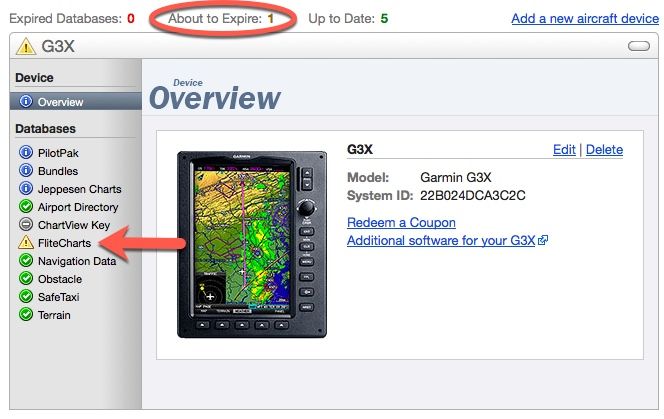

Here we go again. I'm resurrecting this issue in a new thread to announce that I own an airplane that's kind of like a boat, because sitting in the cockpit I'm staring at the equivalent of two boat anchors.
I've tried everything suggested by Garmin, been told they are aware of the problem trying to update databases with a Mac, an alternate update method is in the works, and once again I cannot get the Flitecharts database to download successfully.
Even waiting overnight, the next morning the spinning wheel of death greets me, and when I leave the page because that's the only thing I can do, sure enough, that one database update is not installed.

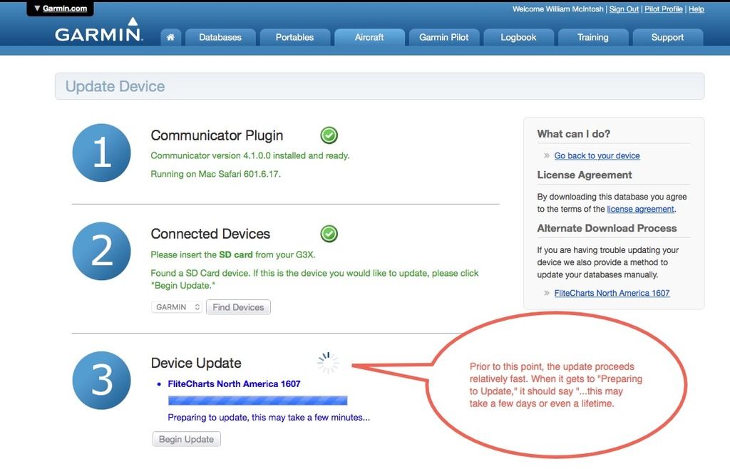

This has been going on since mid-2013. None of the experts can explain why all the databases update smooth as glass until Flitecharts. It's obviously the largest single database, and the individual parts of the update take longer than the others, but something happens when the process enters the "Preparing" stage that prevents it from completing successfully.
I've had update intermittently occur without a hitch. I've had the failure occur the first time I tried and not the second. I've left it overnight and found it updated in the morning. I thought this was the answer, but the latest update failed even after leaving it for hours.

IDK, I just updated my navigation data using my Macbook Pro running El Capitan 10.11.5 and Safari 9.1.1. Garmin Communicator version 4.2.0.0. No problems, but your Garmin Communicator is an earlier version. Is it just Flite Charts that has the issue?

My MacBook Pro is brand new with upgrades in RAM and processor speed, the update screen indicates I have the latest version of the Communicator, I get speedy, successful downloads of all the databases up to Flitecharts, and then it takes a while to get to the last step with the message about "preparing . . . this may take a few minutes . . ." and it hangs up as long as overnight.
From that point, when leaving the page I've found that the Flitcharts did update when I got back to the databases page, and also that it didn't. Like now, when it hasn't updated successfully in multiple tries.
At one point I thought it might be a problem with the browser. I switched from Firefox to Safari, and although it still took hours, when I checked the status it had updated successfully.
The screenshot in your original post shows Garmin Communicator version 4.1.0.0 - the version on my machine is 4.2.0.0.
I'm curious if you migrated data from your old Mac, or installed everything fresh...
Uh . . . Good catch. I'll check that now. I migrated the data, and if I had any indication that corruption or other problem with the previous Mac had anything to do with it, I might have done it differently.
