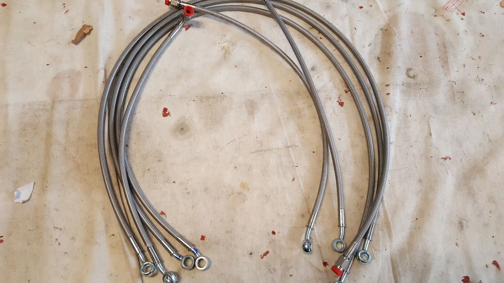

We've been working with a few RV14 builders on the Beringer Brake conversion. Both RV14 and 14A. Having has several conversations with Vivaine, and Claire and a long phone conversation with a 14 builder, we came up with this cabin brake hose package. Its prototype, based on or stock Vans hose package, but modified for use with the crimped banjo hose ends to connect to the master cylinders and the calipers. At this time, they havent been mounted, but they should fit well. The crimped banjo hose ends are 2 versions, one a 20* side bend, and the other a 20* forward bend. This gives (in theory) alittle more clearance around the master cylinders over a reusable hose end.
Notice the caliper mounting is different than what you normally see. It is also going to change the length of the gear leg hose, and that is to be determined. I'm not sure if all the wheel pants hardware is going to clear with the caliper in this postion, but from the client mockups, he states it will. I plan to visit him shortly to see this for myself.
On another note, we know of a RV8 builder that has Grove Gundrilled gear legs, that was having issues with this caliper mounting location. It was covering the fluid exit port on the bottom of the gear leg. We are working with Beringer to see about fixing this issue, so we can make connecting hoses for the calipers, like on the Grove and Matco installations.
Once we verify the fit of all of this, Steve and I will release cabin hose packages for the 14 and the 14A. We have a project to install the parking brake valve AND an antiskid valve, so all of this will take some planning.
