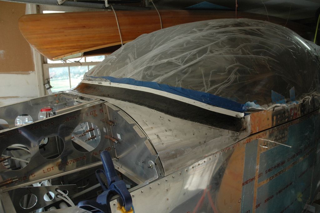

Default Fiberglassing
Nearly completed the fiberglass fairing on the front of my windscreen. I may be the only one here who loves doing fiberglass and epoxy work, I think it reminds me of boating
I tinted the epoxy with.... India Ink.
Don't laugh, I've been doing it for years, mixes readily with the epoxy and has no noticeable affect on strength. Some more filler coats of thickened epoxy, some more sanding and I should be done.
You, and Dan Horton.
Lookin' good so far. I'm sure this type of work is the most closely scrutinized by other RVers at fly-ins and such, so it's worth putting in a lot of effort to make it nice.
What is that attach bracket forward of the left sub-panel riveted to the longeron?
