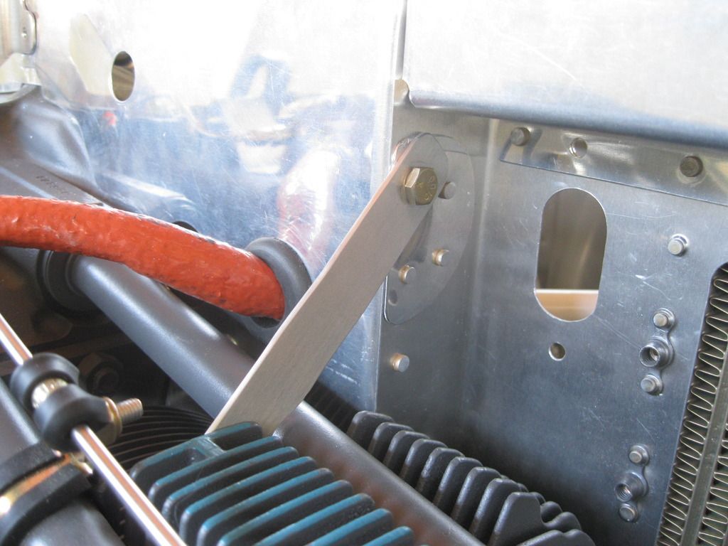

Baffle cracks: Sure enough, the baffle is cracking along the outside left rear corner at the oil cooler mount. Tomorrow I am going to fabricate a doubler angle that will be well secured, with the goal of lasting until I order some new parts and make a beefier setup. Should've listened to those before me...

Sorry to hear about your baffle crack. Did it occur at the top of the intersection? When you redo the baffle, consider fitting some sort of brace to reduce the flexing. Lots of variations out there, but I bolted a piece of flat stock directly from the baffle (with a D-shaped gusset) to the cylinder head fins of #4. It's remarkable how it stiffens things up.
this simple and compact alum oil cooler brace has been successful for 450 hr. no signs of distress. I think the key is attaching to the oil cooler bolt. this is on the old style baffle kit. no other added pieces to baffle kit other than the brace.

Actually, my crack is on the outside of the baffle at the rear corner. I have seen others with cracks here as well, although I do plan to brace the entire area and hopefully avoid any more.

The reason that the crack is where it is, is because that is where the baffle is flexing with the weight and vibration of the oil cooler. If you brace the inner side of the oil cooler to something, then that vertex of the baffles won't flex and crack.
I added this brace between the oil cooler and cylinder head and it makes it extremely stiff. No cracks (yet).
Stainless steel tubing, flatten the ends, drill a hole at each end and then use a longer bolt on the rocker cover. The hard part is getting the angles of the bends on the tubing correct.
I also reinforced the baffle with some angle.
Makes sense. I will incorporate this idea for sure; thanks!

you might try stop drilling the crack and adding the brace and then keeping an eye on it.
Shame on me - I copied this design. :D 1. larger angle on the corner, 2. tied the outer stiffener to the top left hole in the head, 3. inside brace back to the head at the back of the VC screw.
The trick to the inner short brace fab (for me) was to take a strip of aluminum, bend the ends for a PERFECT fit to the angles, drill the holes, then transfer the holes to a bench jig of steel (two pieces of 1.5" angle iron at 90 deg), then match drill the second hole with that clamped together on the bench. Angles and holes matched perfectly.
I made mine from a solid bar as the tubing just looked too big. Heated with a torch and beat the ends flat. YMMV
