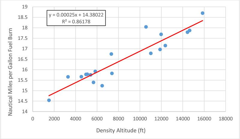

Hi David, what airport do you operate from? I'm in Clarion, PA, not too far away, and we fly over your way often.
As to your question, I suspect that fuel costs, defined as miles per gallon, are more similar than most people might think. I've spent a lot of time collecting and verifying efficiency data, here is a plot of fuel efficiency (nautical miles per gallon) against cruise altitude for my cross country flights.
To make it really simple, I routinely climb to altitude and throttle back to 10 GPH and see about 170 kts. The nine should be able to do a little better efficiency wise, at a slower airspeed, but I bet the difference is small.
Insurance is a function of hull value. Maintenance costs should be similar, except for those two extra cylinders. I'm hoping I don't have to worry about that for a decade or two, but overhauls aren't inexpensive.
