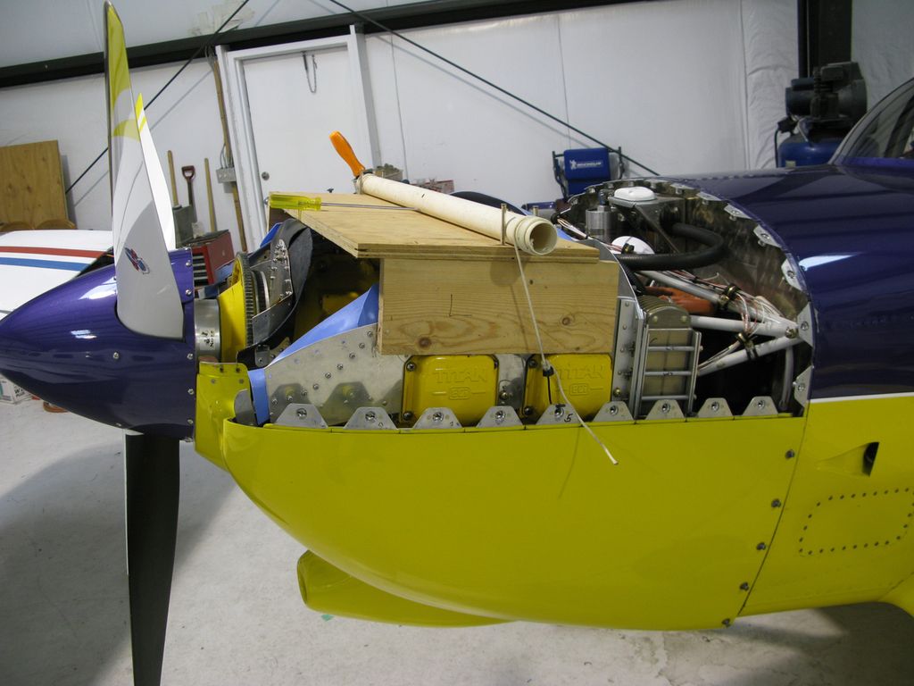

Man, y'all make this sound so complicated! In 1260-ish hours and lotsa oil changes I've never had help or a contraption to drop the lower cowling by myself. Screws at the bottom, pins on the sides; screws out, pull the pins, lower the cowling and pull forward with just two hands, easy peasy, no scratches.

I have a 7A and agree with John in the previous post. I do find it easiest to remove by myself. (Every time someone tries to help it just makes it harder.)
First I fold back and tape all the associated rubber baffling to keep it from catching anywhere. Then I stand on a chair in front and sort of lean over the spinner so I can spread the lower cowl in order to clear the side firewall hinges. Once the hinges are clear I just move it down (back low) until it clears the spinner. Then I just slide it out the front.

If you have Skybolt fasteners on the firewall then this method will work. I use copper clecos in the Skybolt fasteners.

Works well
