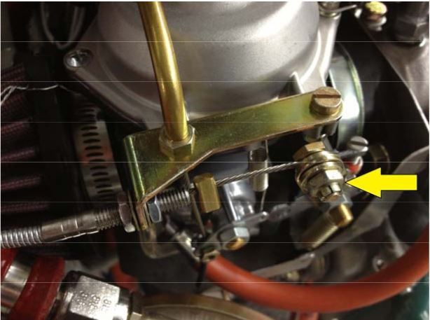

Like most of you -12 builders, we've tried various methods of cutting the throttle and choke cables to minimize fraying. We've used the method in this video on several of our recent builds and WOW!... easy, fast, and the ends are permanently welded together. This tip is worthy of print in the RV-12 plans. (Disregard the nyloc nut... a Van's no no. Ref SB 13-08-29)
Click photo for link to YouTube video
Enjoy... and keep that torch away from the carb.

Originally Posted by Special Delivery View Post
(Disregard the nyloc nut... a Van's no no)
I'm not quite sure what this means.....
The cable bolt and nut shown in the photo you posted is what is on the engine when you take it out of the crate (came from Rotax that way......)
Hope this helps...
The photo in my original post is a Rotax engine operationally installed on another brand of aircraft. I apologize for being cryptic and in the future will be more detailed in my remarks or list direct references.
Ref: SB 13-08-29
