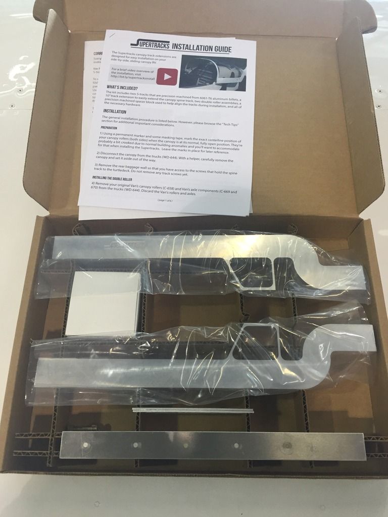

I received and installed my Supertracks on my 6A slider. What an improvement!! I remember my wife and I's first overnight trip trying to get our tiny pieces of luggage in the back. Well no more!!
First impressions. I totally expected the parts to arrive wrapped in paper or bubble wrap and thrown in a box. Not the case. The packaging was superb!! The box you see below was wrapped up and put inside another shipping box. There is as much engineering in the box design and layout as the parts themselves.
