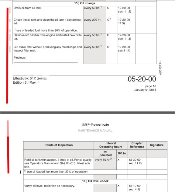

I think we all agree that 25 hours is the correct answer when running avgas. But the answer with unleaded doesn't seem to be as clear. I finally dug through the line maintenance manual long enough to find the maintenance schedule. There, buried a few pages in, was the oil change schedule.
50 hours, oil and filter both. 200 hours to check and clean the oil tank.
Dale

Originally Posted by Harvey rv12 View Post
If I read the maint manual correctly, it says change oil at 50hrs if you use more than 30% avgas, but 100hrs if you use unleaded gas.
I've heard that, but haven't found any documentation to back it up. I'd love it if that were true, but I think it's actually half that. Do you have a reference for the 100 hour interval?
What I found was a 50 hour interval specified in the Line Maintenance Manual Edition 3 / REV 2, chapter ref. 05-20-00 P.16. I'm sure the interval recommended for running avgas is 25 hours, per Rotax SI-912-016R8:
If operating with leaded AVGAS fuel, we recommend a change of engine oil every 25 operating hours.
Dale

Not trying to be argumentative, just trying to reconcile the discussion with the Rotax Maintenance Manual where I think it says oil change every 100 hrs unless more than 30% is leaded fuel, in which case it's 50 hrs. I don't remember seeing anything about 50/25 hour intervals. Did I misunderstand Rotax's manual?
