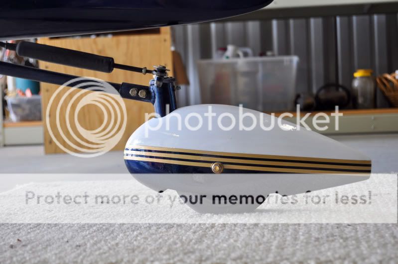

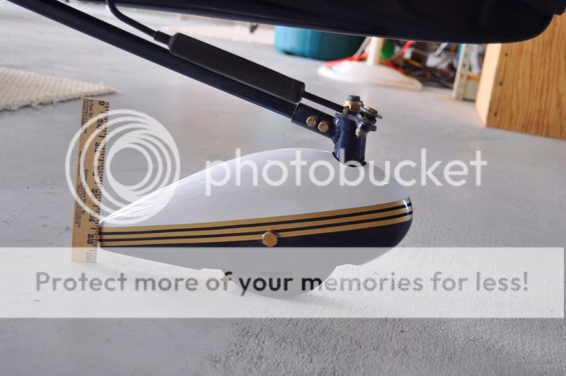

Luca, I applaud you for going old school with the tailwheel fairing! Consider doing what I did and buy a fork from Vince Frazier (previous post) and actually embedding the fork into the fairing. I glassed mine permanently into the fork and it really makes for a solid setup. Just be careful with the geometry such that when you rotate the tailwheel 180? there is no interference with the tailwheel spring or the ground. Here are a couple of photos, good luck with the project:
In the old days there were a lot more tail fairings around, what can I say, the tradition kind of died out, but there's nothing as pretty as a faired tailwheel in my humble opinion. Of course, you'll have to buy two forks from Vince because you'll want to have the other one for grass strips!
