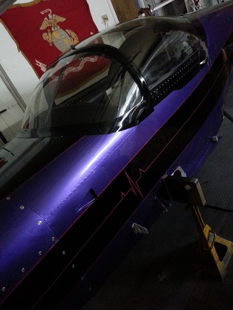

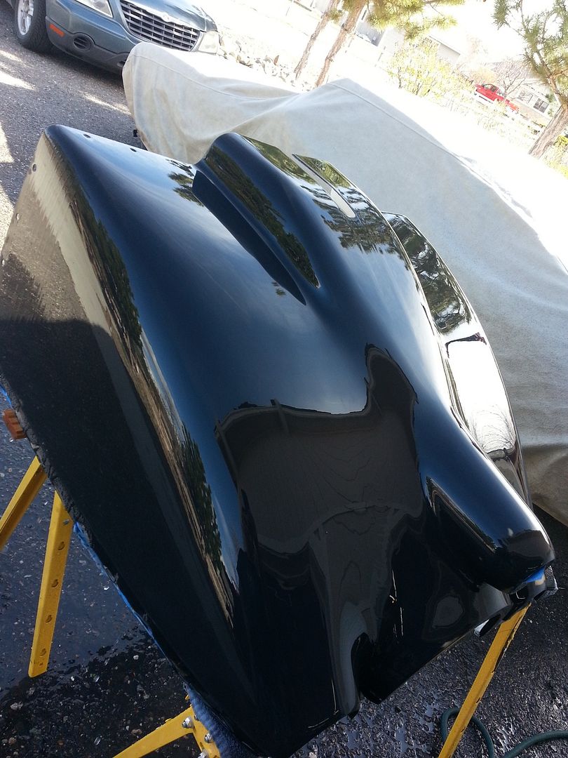

Fresh water running off black epoxy primer, days and days and days............and days of block sanding west epoxy and just today primer, no pin holes! now if I can paint this with no runs.......inside is blinding white acrylic enamel on top of epoxy primer on top of two layers of west epoxy.

I had my son over for a BBQ and to help me rivet the steps on last night, only a year or two more to go!

Default Bret - I think we may have a similar background
Nice paint on the plane BTW - looks like an ECG line....
