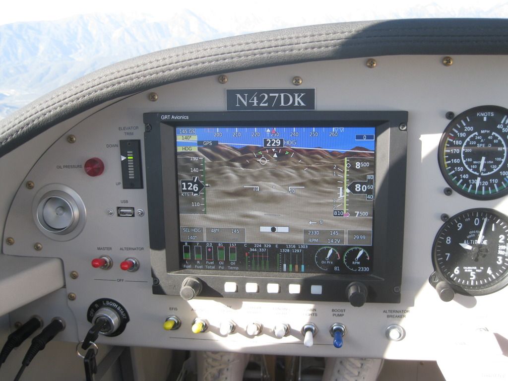

I think the standard row of toggles can be very effective, provided they're not spaced too closely, the control stick doesn't hit them, etc.
To me, color coding is the key: red for master & alternator, yellow for EFIS & avionics; white for lighting functions; and blue for fuel pump. I prefer the "reds" to be a little higher, for less chance of accidental bumping. I like to fly with the the lights on all the time (except cabin lights!).
Doug
