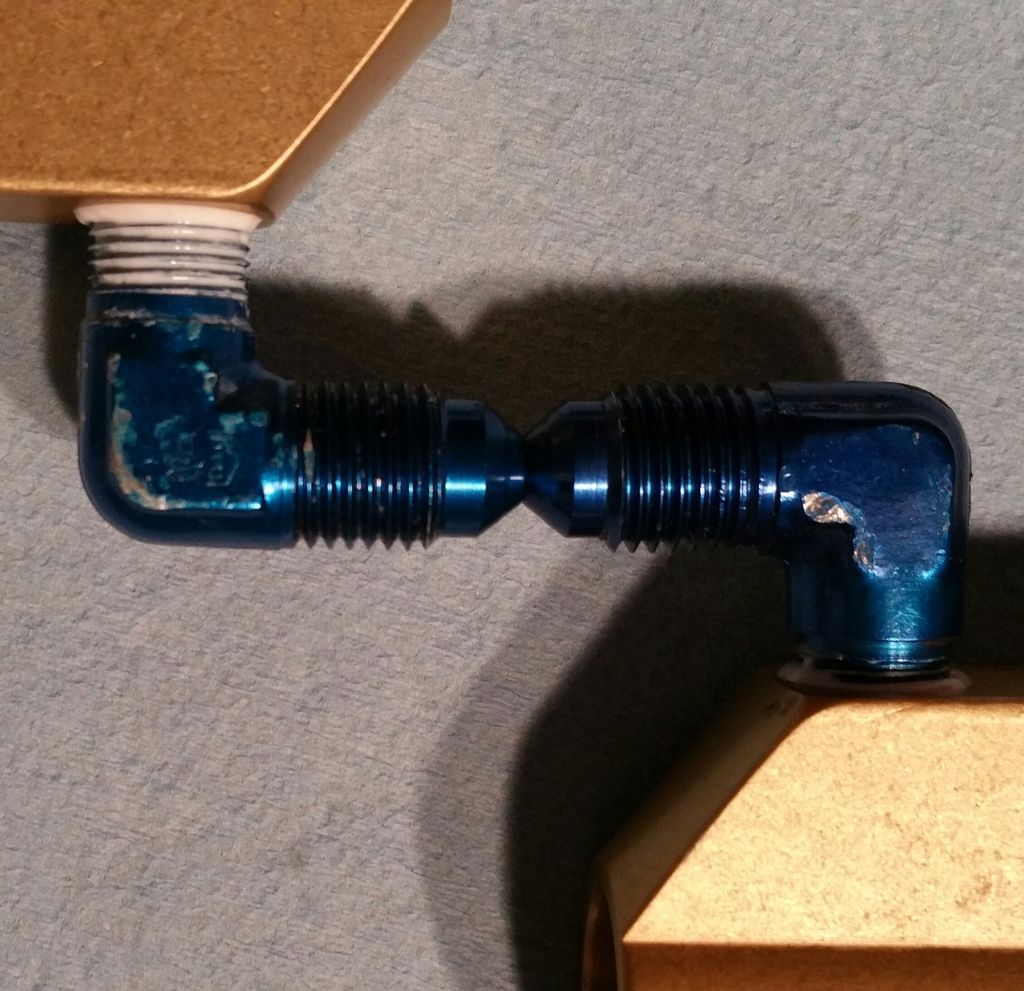

take the two fittings, put the bevel sealing area together, if it makes a right angle, 90 deg, those are the wrong ones for our plane. those wrong ones are SAE 45 deg, not JIC 37 deg

OK, let me go a little further. What makes them wrong for the plane? Provided they meet the required spec of the brake system (AN or mil-spec or some similar standard) wouldn't the type of female nut on the end of the brake lines themselves determine the appropriate fitting (45 or 37 degrees) on the line side of the elbow??
Maybe I'm just slow but it seems like we are trying to determine if the fittings are appropriate for the steel lines the builder used on the plane. Beyond that, I may still have some substandard brake component but at least we would know if the builder's chosen elbow fittings are the correct ones for the lines??
I won't be near the fittings until the weekend to check them.
EDIT: From Wikipedia
The refrigeration and air conditioning industry usually uses 45° flare connections while hydraulic hoses are usually 37-1/2° flare connections.
OK, so I hope I actually have 37 1/2 deg fittings but I won't know until Saturday.

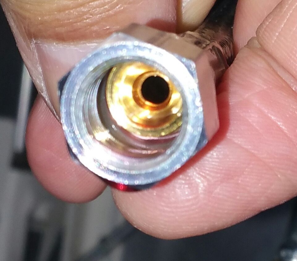

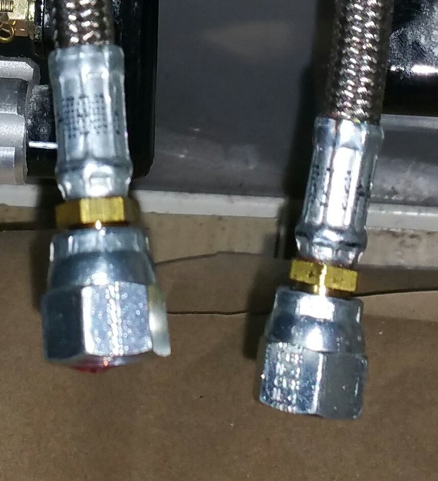

Ok, so I do have 45 deg SAE fittings.
Here are a couple pics of the female fittings. There don't appear to be any markings on them to help with identification.
Any ideas? Next steps?
I'm trying to get some info from the builder but I'm not sure that will be quick.
Thanks! Andy
