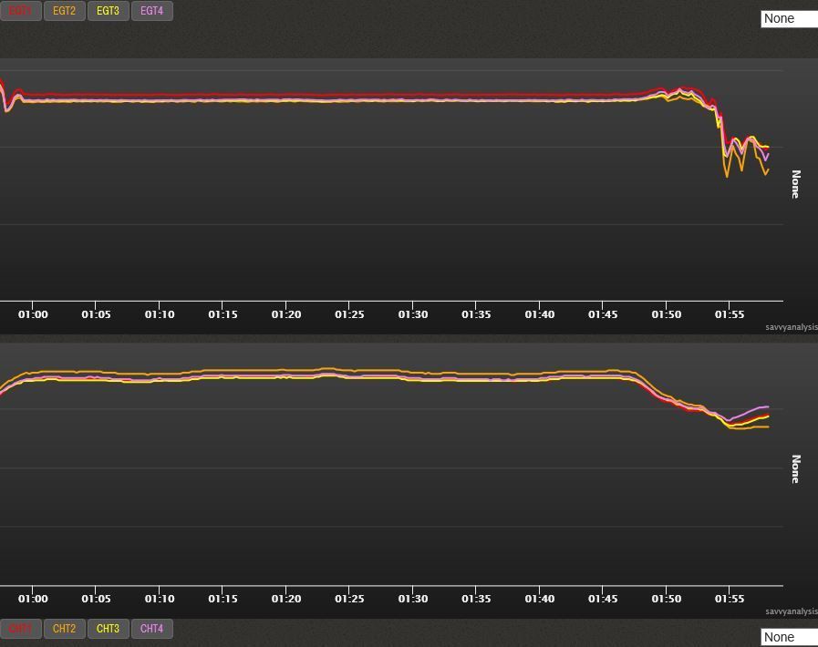

Originally Posted by Taildrgr View Post
Carl,
I have done 3 GAMI tests while flying at 75% and 65% power. All had a GAMI range of 0.4 gpm.
Would this test show the spider and injectors are ok?
Also, all my EGT's at cruise are within 50 degr F when leaned to 100 ROP = 1300 degr to 1350 Degr. Probes are 2 inches from exhaust flange.
Max EGT spread at idle is 100 degr. Lowest is 900 degr and highest is 1000 degr.
This thread has nice photos and description of how the spider works:http://www.vansairforce.com/communit...ghlight=spider
In short, the spider functions differently at idle compared to at power. Recommend you:
- With the engine at 1000 RPM or so, lean while watching EGTs. Is one cylinder EGT rising faster than the others? If one cylinder goes down while leaning it is already LOP - and is a problem.
- If the above test shows a problem, do the shot glass flow test (throttle set at fast idle, move the mixture to full rich, engine off, boost pump on). You are looking for close to the same fuel out of each spider tube.
On EGTs, absolute value is nice to know but is only a rough indication. Fuel flow when each cylinder peaks is the data you want.
0.4 gph GAMI spread is what one would expect with stock injector nozzles (0.028"). Find out which cylinder is peaking last (more fuel than desired) and install a 0.027" or 0.0275 injector. Don at Airflow Performance sells these in various sizes for ~$21 each.
I assume you have already eliminate intake leaks or ignition/spark plug issues, and have verified mag timing.
Carl
  #23
Old 03-29-2016, 11:01 AM
Taildrgr's Avatar
Taildrgr Taildrgr is offline
Join Date: Jun 2011
Location: DFW Area, TX
Posts: 229
Maybe these pictures will help.
Here's one of my GAMI tests that showed 0.1 spread. This was back in January on a cold day. About 38F OAT.
Here is the EGT right after landing on my last flight that had the surging. Note that the engine is NOT surging here. Taxi was normal. Only started surging after fueling up at the pumps.
Only showing this to see about the EGT's at taxi leaning. I did not download the file for the taxi from the pumps to the hangar.
In the middle of the graph at 1:55 was when I increased RPM to 1100 to turn off the runway and then I leaned the mixture for taxi.
You can see that EGT 2 was low by 110 degr before leaning and 80 degr after leaning. Does not look too significant.
Here's the cruise part of the flight running 100 degr ROP just for reference.
The engine runs smooth so I have not checked the resistance on the plugs, but they are all gapped correctly.
Even when it is surging, it is not like a stumble. It is more like a rolling surge. I will get a file downloaded if it does it on my next startup.
Thanks for all the help on this puzzle guys.
I will plug the sniffle valve on the next flight.
Bob B
RV-7A Sold
RV-4 Sold
DFW TX
Dues Paid
