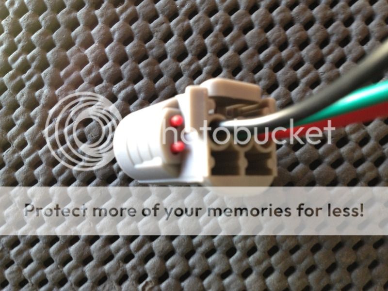

These could be available at the local auto parts store. I got a couple on-line at www.repairconnector.com Part no. RC1650, $12.99ea.. It comes with a 6" pigtail and three butt connectors. However, the wire is PVC, not Tefzel. Could come in handy in a pinch. I potted mine with grey, sensor-safe RTV.
You can find them other places also. Google "hitachi Nippon denso oval plug".

After 550 hours I just broke the middle wire in the connector housing. Of course it would have to happen in IMC. I ordered a new crimpable connector from these guys: http://www.bmotorsports.com/shop/pro...oducts_id/1705

Outstanding! Thanks, in spare time I have been looking for these parts separately. Good parts to have on hand. The inserts eliminate the wiggle and need to pot the ends!

Well, First off...Thanks Dan for this post! I didn't think I would have to use it, but on my way to Bowling Greens this week on the way up from FL my ammeter went to ZERO
It would have been nice if the builder set his VP100 alarm to 13 volts instead of 12! I was sitting fat dumb and happy drinking from my juice box and then my scan looked at the volts going down to 12.4v and surprised me!
I cycled my alternator switch on my VP100 OFF and then back ON with a successful reset. Battery back in charging state and all was good again.
Stopped for fuel in Albany, GA....took off and then an hour from KBWG it goes back to ZERO
Another successful reset and no other issues.
Once in KBWG I pulled off the cowling, plled the pulled off and then gently squeezed the 3 sockets to be a little tighter. It seemed to feel better when I plugged it back in.
Engine run confirmed good connection. Departed back home 4.5 hours with no issues all flight!
Seems like I will be changing out the plug with a new one to be sure.

Has (separately) the 090 sumitomo terminals, connector housing and small plugs for stain relief in the back holes. This way you can reuse your tefzel wire to the plug. They ship pretty quickly. Genuine Sumitomo too. Yes, for the ND/PP alternator.
