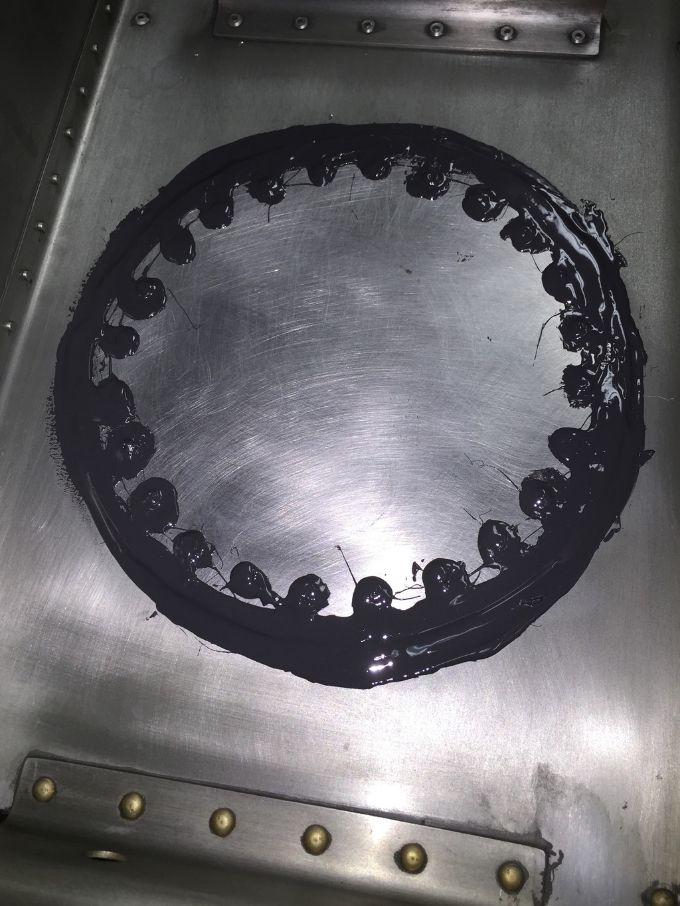

Long story short, I need to replace my fuel sender units after I finished constructing the tanks. Those of you that have done QB wings, how did you seal the sender unit? Squirt a little pro-seal in each nutplate and then seal the head of each screw? I'm thinking that would do it...

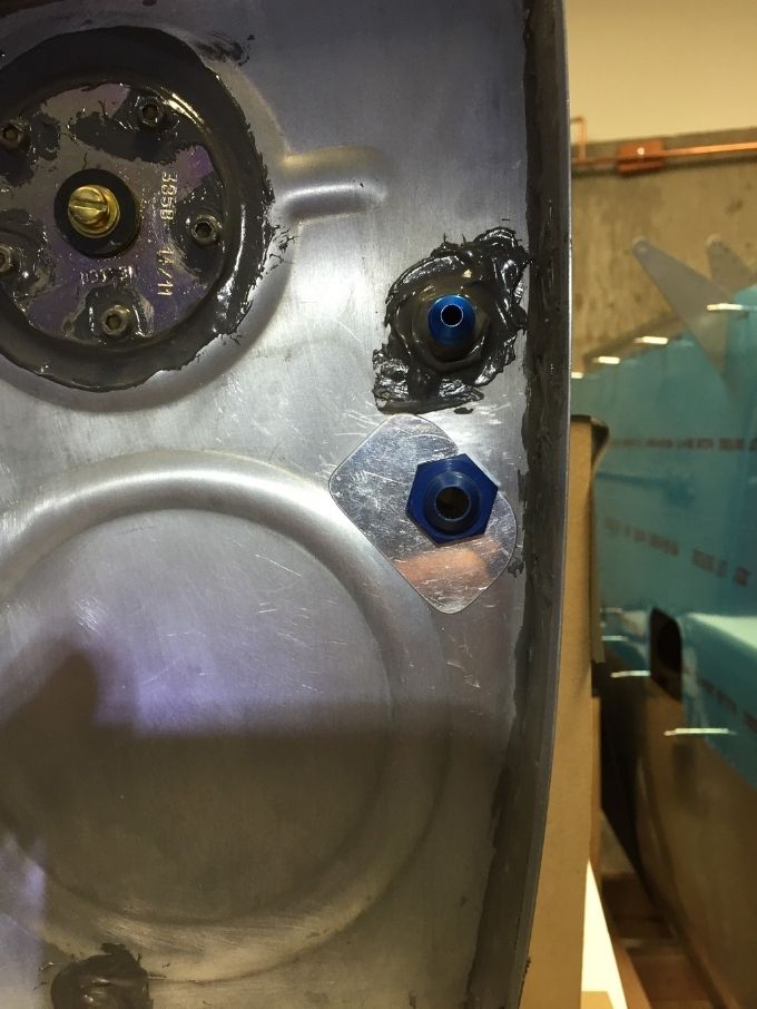

I recently replaced my sending units in my 6A. I don't trust gaskets or permatex immersed in fuel. I Prosealed mine in place without gaskets, Proseal on screw threads and a blob over each screw. If I need to get it apart I'll deal with it at that time.

I used an ohms meter to test the sender and make sure that the float was against the top and bottom of the wing at the senders min and max read out respectively.
To seal I discarded the rubber gasket as per Vans (although that has been debated on this site) and used pro-seal just as Eric described above. I haven't put fuel in it yet however it did pass a leak test with no problem.

Vans recommends sealing with ProSeal. This is what is on the 14's instruction:
Discard the gasket supplied with the fuel level sender.
Apply a 1/16" thick layer of sealant to the area of the rib where the fuel level sender will be installed.
Place the fuel level sender in tis position on the rib but do not push it down into its "bed" of sealant.
Start a screw into each hole in the fuel level sender. Note that a lock wash is installed under the head of one of the screws. This should be free of sealant as much as possible for a good electrical ground connection.
Evenly and progressively tighten the screws just enough to cause sealant to bulge evenly from underneath the perimeter of the sender plate.
When finished, there should be a minimum 1/32" layer of sealant between the rib and the sender.
Leaving a thickness of sealant is important; should the sender ever need to be removed, it allows sufficient gap for a blade to be inserted between the sender and the rib to cut the bond.
Check for continuity between the ground plate on the Fuel Level Sender and the fuel tank skin using a multimeter.
