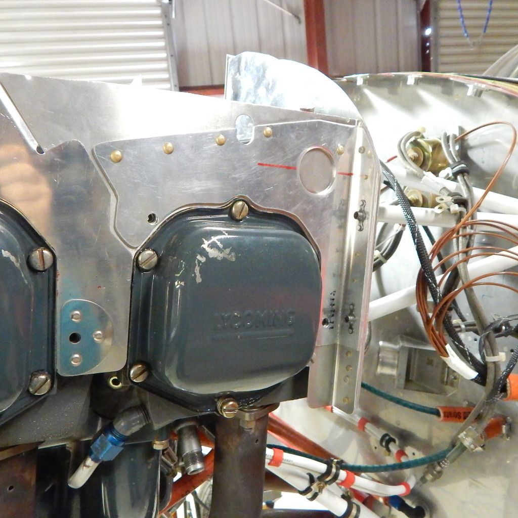

Not sure if this will help, but I cut my oil cooler opening a little too high and the oil cooler was interfering with the upper cowl. So, I used 1/8" U channel to construct a little "duct" that moved the oil cooler down and aft a little. As you can see below, it's a very stout setup. Not shown also is a 4130 steel cross brace reinforcing the inner side of the cooler with one of the cylinder heads. I'll take a photo tonight and post it.

Thanks for that photo Mark! I'm right at this point too. I spent last weekend trimming the baffles to fit the upper cowl and this aft corner is very tight and, I haven't gotten to the 3/8"-1/2" clearance yet; I was worried I might have to move things around to get it all to fit. Looking at your picture it looks like I still have a ways to go...

You just don't have a lot of room in that corner as you want to keep the cooler as high as possible so you don't hide it behind the cylinder, but even at the highest mounting, a lot of the cooler is blocked by the cylinder. By moving it back and down a little, you allow a lot more air to flow and give yourself clearance from the cowl at the same time. Of course, you also need to strengthen that corner and the 1/8" U channel, combined with the 1/8" angle on the forward side of the corner makes it very strong.

Here are a couple of additional photos of my installation.
Hope they help!
