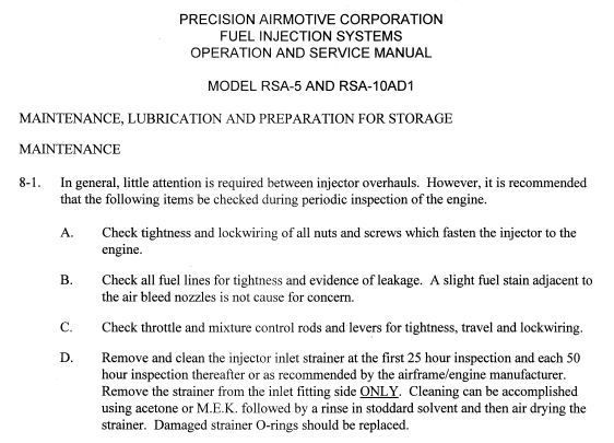

This is from my Precision manual:
Calls for 50 hour inspection of the inlet strainer or per the airframe manufacturer.
So as the builder, I inspect mine at the annual CI.
I also check the boost pump filter annually.
Bob B
These where what I had as well. However, I think there is a newer instruction set out there that might be causing the confusion. I was "told", don't want to start any rumors, that the manufacturer found people where damaging the inlet and it just wasn't worth the trade off. If that is true, some people just shouldn't do their own maintenance.
Please, this is hear say....so treat it as such.

My manual does *not* say to remove and inspect it every X hours; it has the wording which I quoted above, essentially, don't take it out unless you have a reason to do so. So I must have a later version (not at the hangar right now to check the revision date).
From Precision's website:
http://www.precisionairmotive.com/Pu...s/25-020_c.pdf
dated 2/23/15.

The one I posted is dated Nov 8, 1996 and not for the experimental model.
Maybe there are different requirements for the certificated version, or as you said, maybe just updated their documents.
