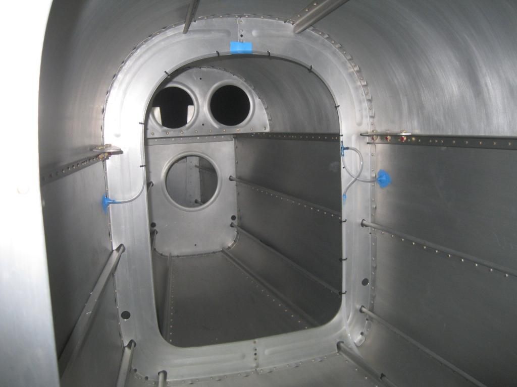

Did you put a little fillet of sealant around the base of the line after re-installing it? (I believe it is specified in the static kit instructions)
If that is done the line will not come off.
Yes, I put a bead of RTV around the line to hold it in place - same as I had before, yet it came loose from the original install.

To close the loop on this - after fixing the line that had come off one of my static ports, my Dynon-calculated TAS agrees with the 3-leg GPS calculated TAS within 1.4 knots at cruise speed and better than that at slow flight, close enough for the girls I go out with...
I'm showing 143 knots TAS at 67% power and 7500' now, without wheel pants and gear fairings.
I'm also showing 140 knots TAS at 46% power and 17,500' burning 6gph - love this 9A wing!!

OK from what I read, a static problem typically causes the airspeed to read too high. Mine is the opposite. It reads LOW. I checked the static system for leaks. Found and fixed a minor leak. But it is still reading LOW by about 5-10 knots. I have BOTH a steam airspeed and a Dynon airspeed (D-100) They both read the same +-1 or 2 knots. IF, in flight, I reach up and disconnect the static from the Dynon, both airspeed jumps up approx 10 knots. Kinda of like using the Alternate Static Source. (And the altitude goes up by about 150 feet )
I have the flat static ports installed both sides about 4' aft of the rear bulkhead. I'm thinking that it must be something about the ports acting wonky in that location.
Thoughts????

Sounds like your static port is in an area of "HIGH" pressure instead of the more typical "LOW" pressure area. Does the error increase the faster you go? This is a quick and easy way of verifying a static port location error. If so then your can either move your static port to a better location or put a wedge in FRONT of the current static port. This lowers the pressure sensed at the static port. Opposite of what we typically find.

Yes it appears to be a larger error, the faster I'm going. Your thought makes sense. I like the idea of using a wedge. Maybe I will need to move the static ports, but I hate to move or add new ports til I'm sure that will solve the problem.
