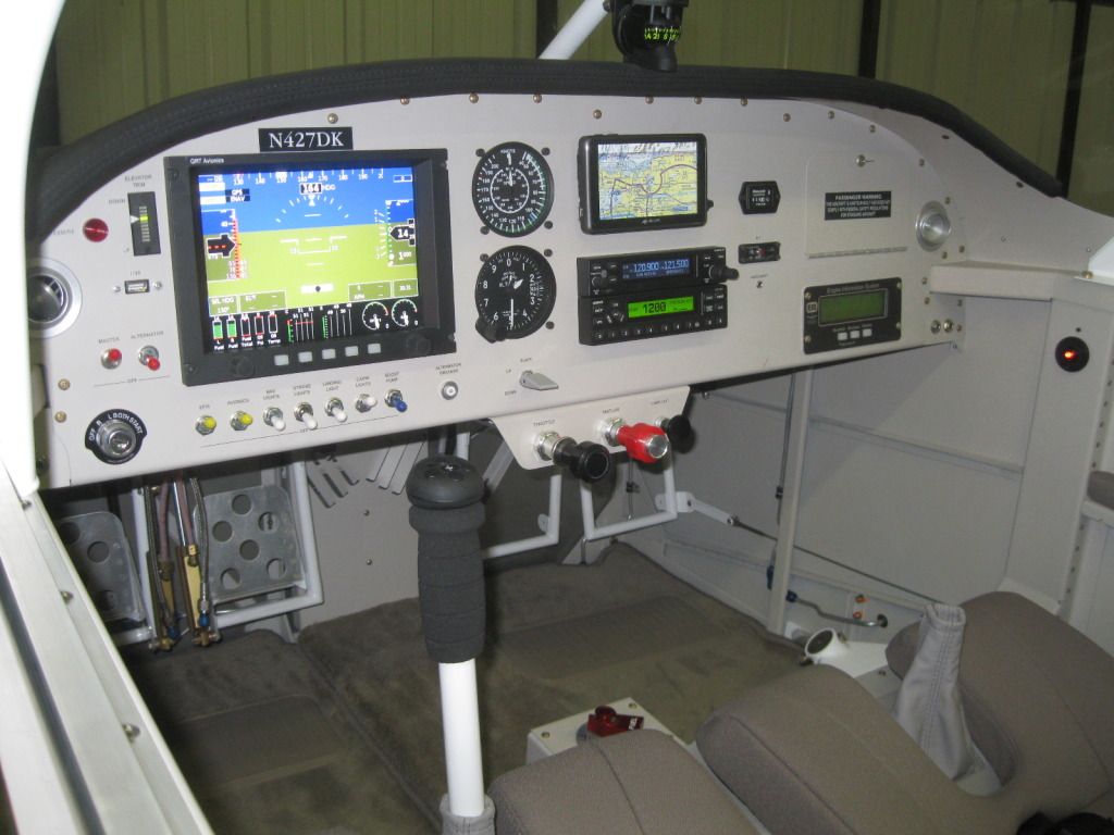

Old 03-02-2016, 02:31 PM
Join Date: Mar 2014
Location: Laguna Hills, CA
Posts: 1,805
Hey Larry,
Mine's a 9A, but here's what I did.
I put all components inline, and then raised the tunnel cover its full length by about 1.75 in. This avoids the lumpy doghouse:
More pics on VAF at my build thread, "SoCal RV-9A"
I like the boost pump, filter and as many fittings as possible aft of the firewall...less chance of spraying high-pressure fuel on a hot engine, and you can smell any leaks inside pronto. Also, everything here stays cooler, so less chance of vapor lock.
Note: After this picture was taken, I changed the line from the Red Cube to the firewall fitting from straight to sort of a question mark shape (with firewall fitting clocked to 9 o'clock) to better account for drumming of the firewall. Pump is on cushioned Adel clamps, and filter is on a bed of dense foam in aluminum U-channel, secured with a cushioned clamp.
Here's what it looks like covered with carpet. On solo flights, it makes it real easy to stretch my right leg over into the right footwell to get all comfortable and such.
Doug
RV-9A "slider"
Tail number N427DK
Donation made for 2020
