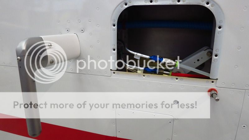

An update on the retrofit: I've cut the hole for the mast. It not the best job in the world - I might need to fill it ever so slightly... Anyway, I've run into a problem with the rivets. I've drilled and dimpled the skin and doubler plate based on the recc's of several builders both here and on my field: holes with #40 bits, and dimpled with a 3/32 pop-rivet die set. The problem is that CherryMax rivets are not available in 3/32 sizes - they start at 1/8 it seems. Should I enlarge the holes for the larger rivet size and re-dimple? Or should I try to use solid rivets? I don't own an air rivet gun or a hefty compressor. I'm sure I could borrow an air gun and bucking bar, but I'm concerned that my $100 Lowes compressor is inadequate for the job.... OTOH, it's only like 10 - 15 rivets that need to be driven, and I'm pretty sure I can get access for the bucking bar through the inspection plate...
I'm looking for recc's or suggestions, thanks!
Find someone on your field with riveting experience and a compressor to help. I would finish the job with the #3 rivets, it can be done fairly easily for someone with experience. CherryMax rivets are total overkill for this job and you can avoid the redo of the dimples, etc., by just going with what you've got.
I did just that: the local guy who recc'd the CherryMax solution earlier determined that my compressor could handle the riveting job. He dug around in his vast hanger (actually the same size as mine, but filled to the gills with all sorts of collected parts and tools,) and came up with an assortment of "antique" but functional air tools and bucking bars. Together, we installed a doubler for my belly VHF antenna that was somehow overlooked during its initial construction, and riveted the new Gretz pitot mast. It turned out well - only had to redo one rivet, but we did chip some paint which was expected....
On a related note, has anyone tried to chrome their Gretz mast? Might look cool.
Here's the photo taken today. Let me know if you have any questions.
Pat,
I saw this post and will doing a panel retrofit soon using Garmin G3X touch screens. I currently have the standard Van's 1/4" tubing pitot that I will be replacing with a Garmin heated Pitot/AOA and using the Gretz mount. I like your idea using the old pitot hole for the OAT sensor however I was wondering if the fact that you mounted the new pitot with the Gretz mount near the outside inspection plate if it interferes with your tie down and chains when securing your plane?
