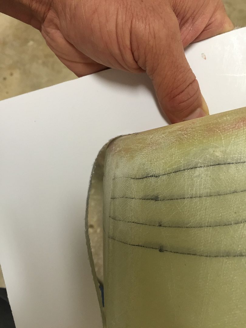

I've been gone for a couple days, just so happened I was in a window seat just forward of the engine. When takeoff power was applied fog/vapor was forming around the inboard edge of the inlet until approximately 60 knts. I'm guessing the engine was sucking air from behind the lip until airspeed was delivering the correct amount of air, at that point it was spilling over the sides. Unfortunately I didn't get my phone out fast enough to take a pic of the vapor/fog.
The NACA report DanH mentioned in a previous post used a 10.4 inch diameter cowling, my inlet diameter is 5.75 inches. My 6th grade math is solid, after that I have a general idea but I usually need the answer to work my way backwards through the math problem.
To get a properly sized curved lip for my size of inlets should I set up a ratio like: 10.4/5.75=1.81 inches to correctly size the curve to my diameter inlet?
If the diameter of the inlet is the "y" plane, and the distance behind the inlet is the "x" plane should I divide both the x and y distances by 1.81 to correctly size the curve for my inlet? I remembered this little conundrum only after ploting out the ordinates in the charts on some foam graph paper. Ordinate Chart from the NACA report (Wikipedia has a good explanation of "ordinates"):
Here's the ordinates from the chart graphed out on some cheap foam graph paper (Walmart), I graphed inlet curve 1, 2, B and C and cut out C since it was the lowest drag shape. Looks like my original shape was close to 1, and my newer lip shape fits C nicely up front. Being the ordinates are for a radial engined cowling that tapers much more than my cowling I have a little "customizing" to do. I think I can disregard the aft 1/3 of the ordinates and blend it into the existing cowling shape.

FYI - I plotted the same dimensions and noticed that was for a diameter of 10 or so inches. I was thinking about scaling the curve down proportionally to the diameter of the inlet. Once I did that it is not much different than the SJ original shape, a flat spot and progressive curve.

Yes the study did use a 10.4 inch opening, I thought about scaling the curve down as well but not sure that it needs to be rescaled.....but I can make cases for both in my uneducated opinion.
I think the radius 1 is very similar to my original shape and that of SJ's cowl lips, maybe 25% ish more drag mirroring the same flat curve as lip B and C.

I plotted the ordinates "x" and "C" on a piece of cardboard, I then took C/2 and plotted the curve underneath. I averaged/drew a curve between the two and made a template for my lip curvature. The new curve seems doable to shape into my existing cowling. I made a short and a long template, the short template shows the inner lip next to the spinner was already close to the right shape.
