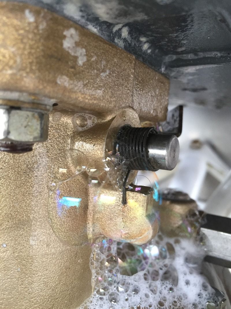

Okay, I finally got out to the airport today to do some more detective work. I hooked up my (clean) shopvac and pressurized the air inlet. The intake tubes were tight, but I'll be changing the gaskets anyway because of age.
What was more troubling was a pretty good leak around the throttle butterfly shaft where it protrudes from the opposite side of the carb. The shaft is not wobbly, but I can push it in and out slightly when the butterfly is wide open. Doesn't move when shut. The air leak varied a bit, but was quite noticeable. I also saw much smaller bubbles around the mixture screw.
I described this to one of our local A&P's, and he didn't seem to think it was a big deal, but your comment on how a leak could affect the idle circuit makes sense to me. Again, the engine idles great at around 1000 RPM, maybe a bit rougher at 700, but it bothers me that I'm not seeing the RPM rise I should at shutdown, and that when I made the large adjustment, to get a 40 RPM rise, it didn't stick.
Do you think this is the problem?

The shaft bushing interface is not designed to be air tight and contains no seal. Air leak there is expect and is not causing a problem. the shaft has no mechanism to stop side to side movement other than the butterfly valve in the throat. You should have side to side play.
Do some more research on this before you get too concerned. Many mechanics tune idle by sound and performance. If your engine is running well don't concern yourself too much. Go research mixture adjustment procedures. I have seen some good articles with more detailed advice. It may just be the testing procedure that you are using.

Yah, they're not airtight. If its worn bad you will see it most at like 3/4 throttle. Not talking slight movement, but actual rattle the shaft with your fingertips worn. The bubbles around the screw are from your air supply blowing back through the idle ports (little tiny holes by the throttle plate edge at idle).
Actual repeat offender.
