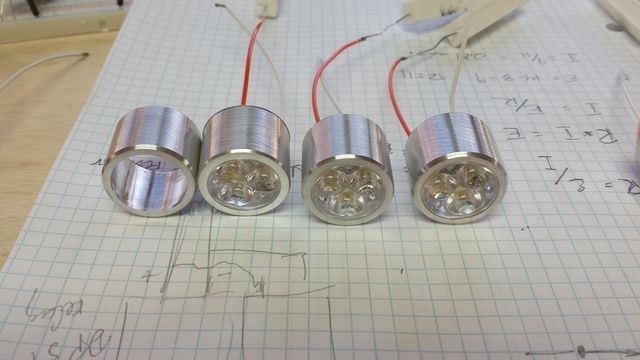

From the other posts, I am probably overthinking this part of my build, but since you asked I'll toss I my 2 cents worth from a different direction. I really didn't like any of the options I was finding, so decided to do my own. I am also tired of the poor lighting in the factory aircraft I am flying now.
All of my lighting is/will be LED done DIY right down to soldering the chips. Here is a photo of the reading lights over each seating position:
[IMG][/IMG]
The details are in my build link below (the 2/19/2016 entry). A short description; the holder is machined out of 1" aluminum. The actual LED assembly could be direct mounted for about a 1/4" thickness. In this case, there are 3 LEDs at 186 lumens each (15 watts = 1 lumen approx.) so 558 lumens is way overkill. There are many optics available, in this case 10 degree beam optics for reading lights. The LEDs are wired in series with a 10 ohm/10watt resistor and a 1000ohm/0.5 watt pot for dimming and a switch to turn off. They go from too bright to look at to just glowing. Nothing gets more than hand warm. They use a little less than 1 amp each. There is no possible radio interference. I almost forgot to add that each light has about $15-20 in parts cost
Anyway, ping me if you want additional details
