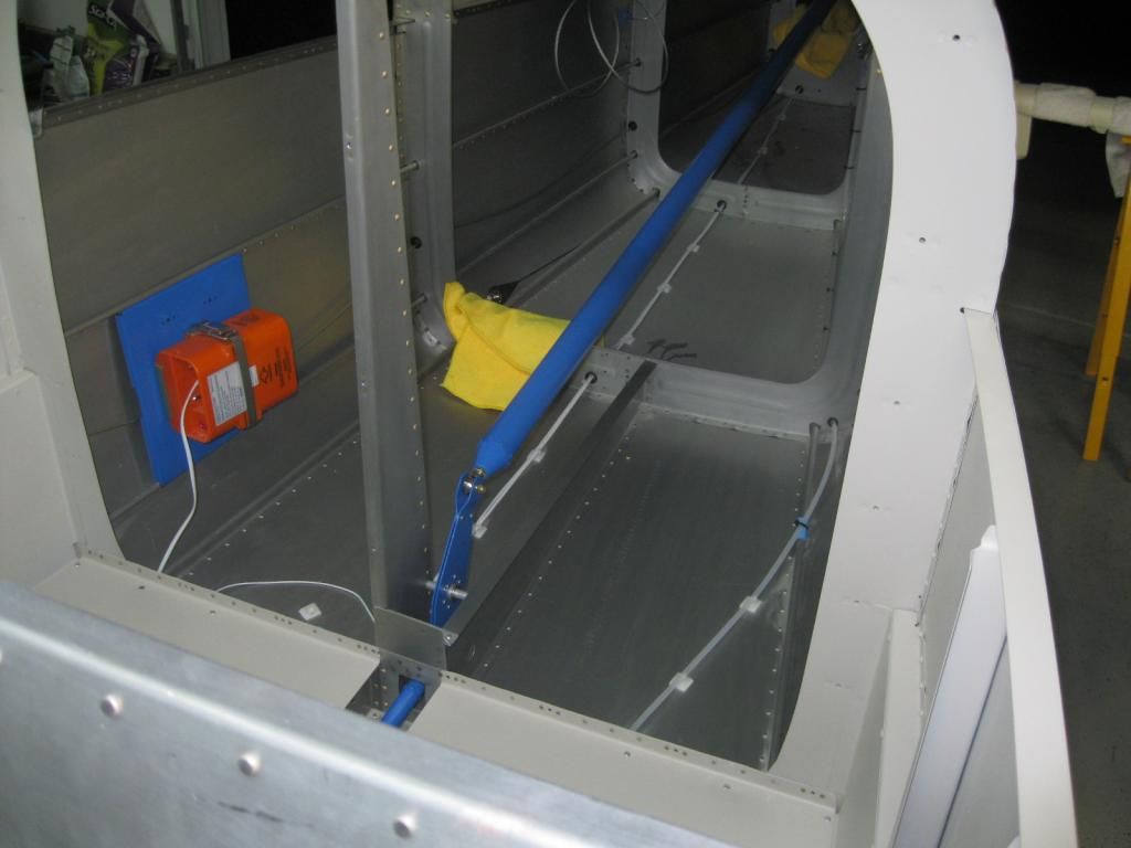

I have a question regarding the photo above, - What is the 2024-T3 material thickness for the blue ELT bracket riveted to the stringers ? .050 or .040 ??
I rather make one myself than buying it .. :-)
