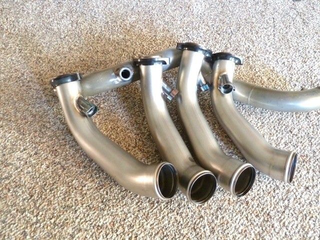

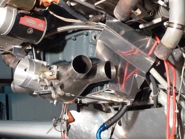

Speaking about intake manifold designs, I posted the photo of the stock 540 vertical sump earlier to show the very small plenum volume and vastly different intake runner angles and lengths to illustrate a likely poor design with likely unequal flow to each cylinder. It breaks every rule we know in this regard.
Here's some photos, courtesy of Dave Anders, of his EFI install on his RV4 with the Sky Dynamics induction. Note large plenum volume, equal entry angles, tapered runners, with bell-like transitions and near equal lengths. This is best practice from the performance/ racing world. And I'd expect this to work better than the stock Lycoming vertical sump. Time will tell.

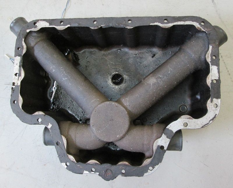

Default Dog's Breakfast
This is a very poor intake manifold. Off 320 Lycoming I believe. Compare to the SD one above.
