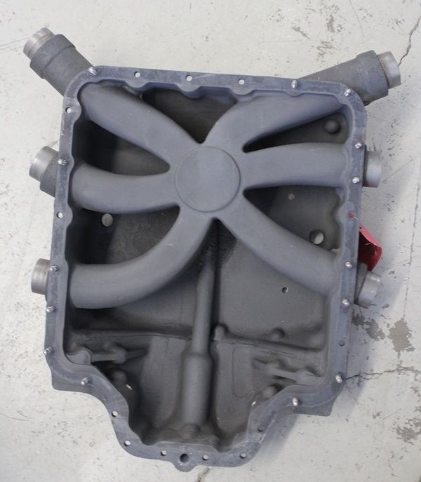

Here's what we're up against with typical vertical induction Lycomings:
Bad pairings, unequal shapes, small plenum volume and unequal runner lengths.
A recent test flight on a four cylinder with the fuel trim option had one cylinder at +2% and another at -9% to get all to peak at the same time. Was able to run at 200F LOP with uber smoothness.
Hopefully have more details soon.

Of course that intake manifold was designed for a carburetor to be wet flowed. But even then, the most we see on most RV-10?s running that sump with our fuel injection (or Precision) is 1.5 to 2.5% total change in flow to get 0.2 GPH spread. On four cylinder up draft sumps it?s usually less than 1% to 1.5%. The Superior front sump is better. But the exhaust system plays a big role in the air distribution also. So if the engine you were working had an 11% (+2% to -9%) spread in airflow between cylinders then I would say that the engine was really screwed up. Or perhaps the fuel distribution was not equal, to begin with.

I'd use the word "designed" here loosely. Lycoming simply joined everything together so it fit. Huge GAMI spreads are not uncommon on Lycoming engines as delivered with a variety of sumps. I'd look towards the transverse, Sky Dynamics plenum for something that's designed properly. One client has that fitted along with Lycon flow matched heads and equal length exhaust. Will be interesting to see what the basic spread is on that one.
The owner can comment. As far as I know the engine is fresh, not sure what exhaust he has on it. He changed to a Superior sump and it changed nothing in his case. Swapped injectors to different holes and that changed nothing. Clearly he has a bad case of mixture distribution which is why he wanted it fixed. This technology brings the spread to 0 at any power setting/ rpm- from the cockpit, in 45 seconds. That's as close to magic as things get in the Lycoming world. Trying to bring these engines into the 21st century with modern electronic controls and features. I don't design manifolds for Lycomings, just provide the tools for our customers to fix any imbalances they have.

As Ross stated, yes I did swap the sump from Titan (ECI) to Superior with no noticeable changes, so the sump swap was a huge waste of time and money. As can be seen in my screen shots, the engine is a new Titan IOX370 (100 hours) running standard Vetterman crossover exhaust.
With the help from Rusty Crawford, this modification to my existing EFII setup only took a few hours and was relatively simple.
As the pics below show, after 45 seconds of tuning, I went from a GAMI spread of 1.3 to a GAMI spread of 0. Engine runs smooth all the way to about 200 deg LOP where as before I could only get to about 80 deg LOP since before when 80 LOP, cylinders 1/3 were at about 200 deg LOP.
Another benefit is now I have a clear picture of which cylinders I need to focus on for better cooling. Before I would have thought it was 1/3, but actually I need to work on 2/4 first.
Plus, now I am getting more average power with less wasted fuel since all of the cylinders are making optimum power.
Amazing work by the SDS team and Rusty Crawford. This has been many years in the making! I feel so lucky to have gotten to try this out for them!!!

Since the lack of plenum volume on the updraft sumps seems to be one of the issues, I wonder if instead of the typically seen 90 degree elbow adapter used to convert to a forward facing servo, if you could instead construct a large volume airbox and attach the servo to the front of that? Im thinking a 10 inch diameter, x 3 inch deep cylinder with a servo mount right in front - essentially a very large volume "elbow". Clearly, it would be a partial solution (if it worked at all), but it would be pretty easy to do.

Interesting idea, but I don't think that would do anything to balance uneven airflow. It may increase the airflow overall, but the imbalance would still be there. By tuning the injectors, the imbalance is a moot point now.
