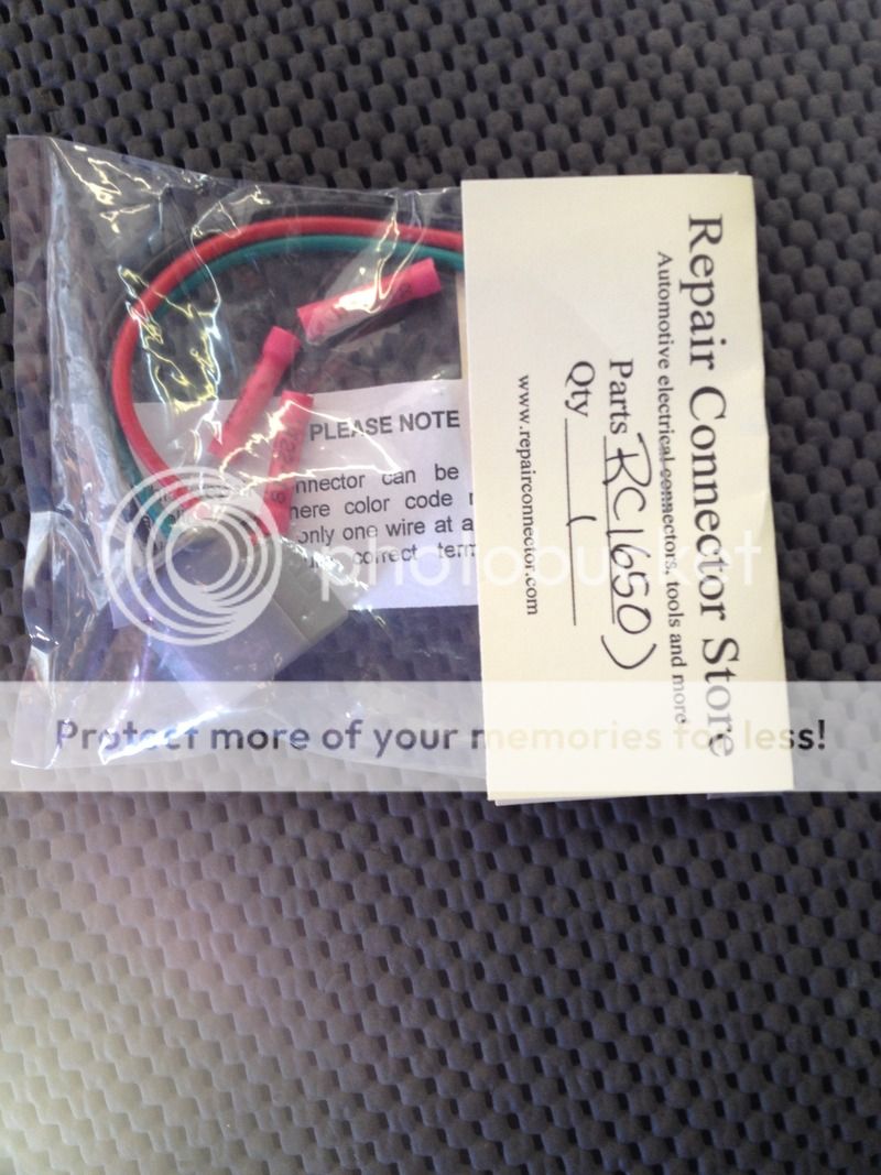

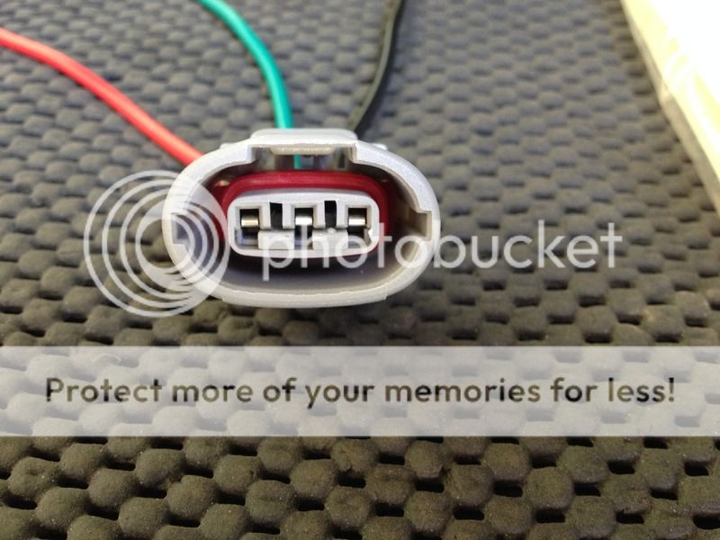

TX7A TX7A is offline
Join Date: Feb 2005
Location: Abilene, TX
Posts: 724
Default Plan Power Plug
These could be available at the local auto parts store. I got a couple on-line at www.repairconnector.com Part no. RC1650, $12.99ea.. It comes with a 6" pigtail and three butt connectors. However, the wire is PVC, not Tefzel. Could come in handy in a pinch. I potted mine with grey, sensor-safe RTV.
You can find them other places also. Google "hitachi Nippon denso oval plug".
Sam Evans
RV7-A O-360 C/S
VAF#812

After 550 hours I just broke the middle wire in the connector housing. Of course it would have to happen in IMC. I ordered a new crimpable connector from these guys: http://www.bmotorsports.com/shop/pro...oducts_id/1705

Outstanding! Thanks, in spare time I have been looking for these parts separately. Good parts to have on hand. The inserts eliminate the wiggle and need to pot the ends!
