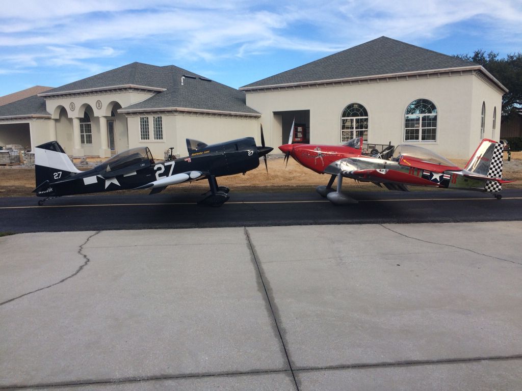

flyboykelly's Avatar
flyboykelly flyboykelly is offline
Join Date: Jun 2006
Location: Port Orange, FL (7FL6)
Posts: 274
Default My first flight complete!
Test flight number three is complete! This was my first flight in the airplane, and all I can say is WOW! That thing is a lot of fun! A problem has crept up with the prop governor. It doesn't want to go to high pitch in cruise. So I'll work with flybox to fix that issue. Also I'll need to add an air oil separator as I had quite a bit of oil coming out of the breather. All of these are normal developmental issues. The Rotec Aerosport R-3600 is running great! Once these two items are fixed flight testing will resume.
Video posted below.
[IMG][/IMG]
[IMG][/IMG]
http://youtu.be/FTtgIse4t1A

Default Electric prop
You may want to consider running the pitch of the prop manually. We Subie pilots have alot of experience with electric props. The automatic modes have had problems with keeping up to rapid throttle changes and you can end up with engine over speeds and lack of performance on go around. A manual mode also saves wear and tear on the pitch mechanism since you only change pitch a couple of times each flight.
We set the fine pitch stop to be like a climb prop giving max RPM at about 120 mph with full throttle. We set the course pitch stop to give desired RPM at cruise speed. This way the pitch is never outside a usable range. I have a bright LED that comes on when the electic motor hits the stop (it senses the stalls current from the motor). I could use a finer pitch stop for better take off but I don't need more and I like to keep my engine RPM down for longevity.
-Andy
Andy Simpkinson
RV-9a Subaru engine.

Brian,
Your plane is not about top speed.
Seems we have a recurring theme here. Ya'll quit apologizing like the family does for a ditzy cousin ("...but she is such a sweet girl").
No thinking person expects the 8R to be fast. After all, it's only got 150 HP. However, I'd bet the next Oshkosh beer tab that it will go faster with a bit of development. And God knows, none of us need an explanation as to why it is cool.
