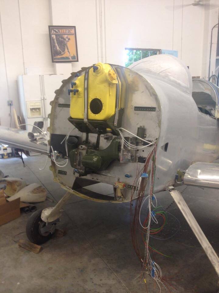

Brian, considering just firewall forward, do you know how much additional frontal area you actually have?
The frontal area of a stock RV8 might be considered the firewall area plus that part of the coal shovel cowl exit which extends below the belly skin line. The Rotec is only 33.5" diameter, so I'm guessing the cowl is not wider than stock.
Dan,
Some quick and dirty calculations based on the CAD drawings Van's has available on their website:
Frontal area of the RV8 as you described: 6.87 square feet...assuming the Van's CAD drawings are accurate.
Frontal area of the radial cowl, assuming 38" diameter at it's widest (that's only 2" clear all around): 8.48 square feet....a 23% increase over the 8.
If we can shoe-horn the radial into a super-tight fitting cowl...say 36" diameter (1" clear all around), that's 7.07 square feet....or only a 3% increase.
Brian,
Not picking on you or your airplane...just an academic exercise with Dr. Dan, because he has that affect on me (he makes me think!)...
Congratulations on a job well done! Your airplane is gorgeous, and giving me a bad case of the wants.
Moose
The firewall is stock between the longerons. All I did was raise and lower it a little bit. I got the original idea to do the conversion because the diameter of the engine was very close to the width of a lycoming. To I was able to use the stock Vans hard points and didnt need to re engineer the airframe. So other than the opening for engine cooling, the flat plate drag isn't to much higher. In the future when I install an efis and can got more data on engine cooling, I may install a larger spinner and close down the gap a bit to gain some additional speed.
[IMG][/IMG]
Flying as of 1-12-2016!!!!!

Originally Posted by Michael White View Post
Dan,
Brian,
Your second diameter would be the correct one. There is about a one inch gap between the engine and cowling all around. Thanks!

[quote=flyboykelly;1046629], I may install a larger spinner and close down the gap a bit to gain some additional speed.
Exactly what Darryl Greenamyer did with his Bearcat. He also filled in the rounded intake lip inside the cowl to reduce turbulence there and has a really small gap between the spinner and the cowl intake...lots of drag reduction possible there.
