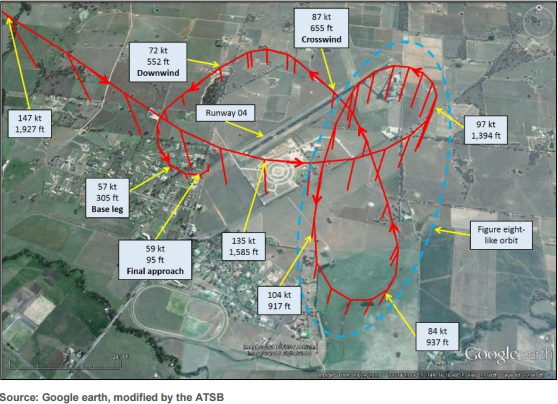

Received an article on my news feed this morning regarding a RV6 that went down in September 2014
It was an interesting read and sure hits home as this could happen to anybody! Thoughts go out to family and loved ones.
Hope we can all learn something from it. Fly safe
http://www.atsb.gov.au/media/5747636...nal_report.pdf

I don't disagree with the idea of making improvements to to aircraft with the goal being to improve crash survivability, but I don't think this accident is a good benchmark to start from.
I am not aware of any general aviation airplane where the occupants fair very well after a stall/spin at low altitude.
From the report.... ATSB analysis based on estimates of aircraft speed, impact angle, and energy absorption indicated that the impact forces imparted to the occupants would normally be expected to result in serious to fatal injuries. This statement precedes the findings regarding airframe damage, so my assumption is that they didn't mean to imply that the damage incurred is what changed it from survivable to non-survivable.
Looking at the in air photo and the photos of the airplane, it looks to me like a partial recovery was made because there is little damage to either wing and the airplane did move fwd a ways from the initial impact point. My arm chair guess is that spin to the left began (the airplane was in a left turn) which a partial recovery was made but resulted in a very high sink rate, but not steeply nose down impact. Odds of surviving that are rather low.
Low altitude loss of control is a primary killer regardless what airplane you are flying......
