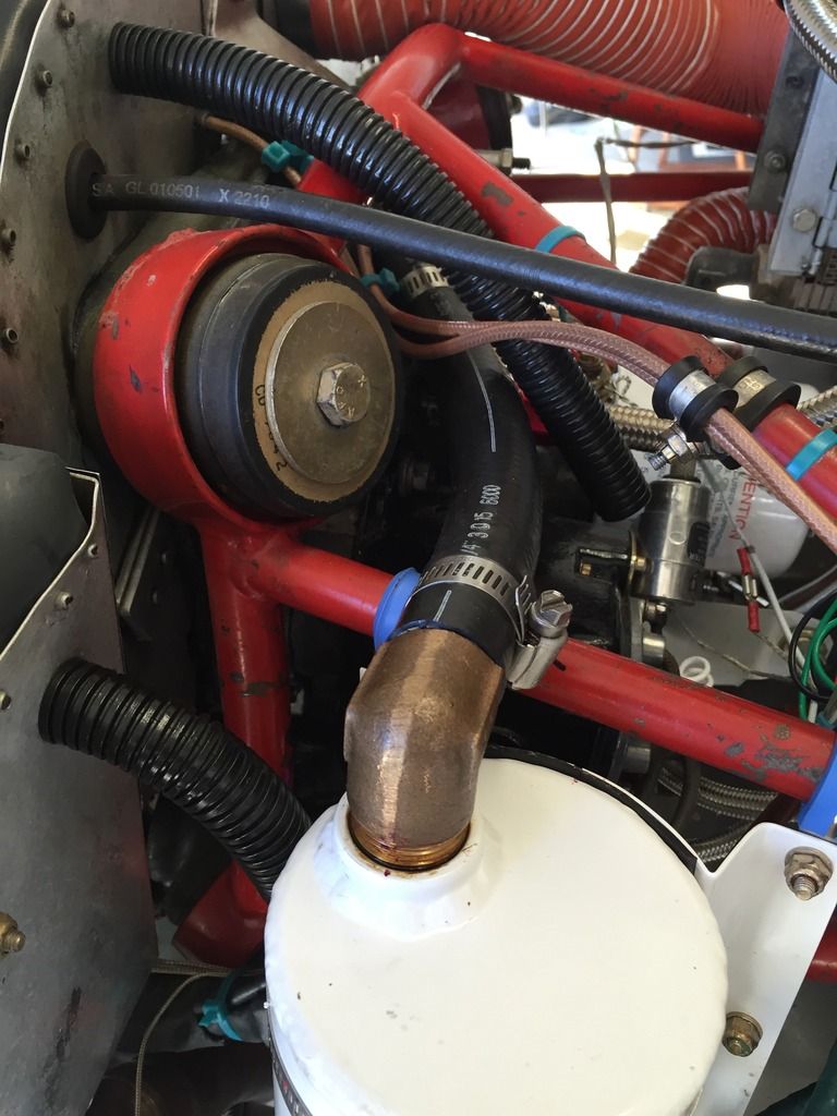

Default My Half Raven
Thanks to the excellent advice I got here, I chose and just finished installing a Raven Inverted Oil System - just the air/oil separator system. This is commonly referred to as the Half Raven since I didn't install the pressure side inverted oil valve components. My objective was to eliminate the excessive loss of oil and messy airplane I was seeing after my aerobatic flights. I have a carbureted 360 so sustained inverted isn't a requirement. I just wanted to eliminate the mess and the oil loss.
I can happily report great success. I flew the first flight today and, after putting the -4 through some very extensive zero and negative g maneuvers, I returned to find very little oil on the belly and no measureable oil loss. Before the installation of this system, I was seeing a quart to a half-quart loss on some of my more aggressive flying days and the belly would be a complete mess.
This experience also highlighted to me the value of the experimental aviation world. I learned a lot. I had to learn about and select all the right mounts, hoses and fittings, sealants, and tools. I built my first ever hoses. I think it took me three different shipments from Spruce and two from Summit Racing, but once I had all the right stuff, it was pretty simple. I enjoyed it immensely and the results provided a lot of personal satisfaction. I want to give a big thank you to the folks the produced the EAA videos on hose fabrication. They helped me immensely!
Also, a big thumbs up for the Raven products. Quality stuff that just works!
