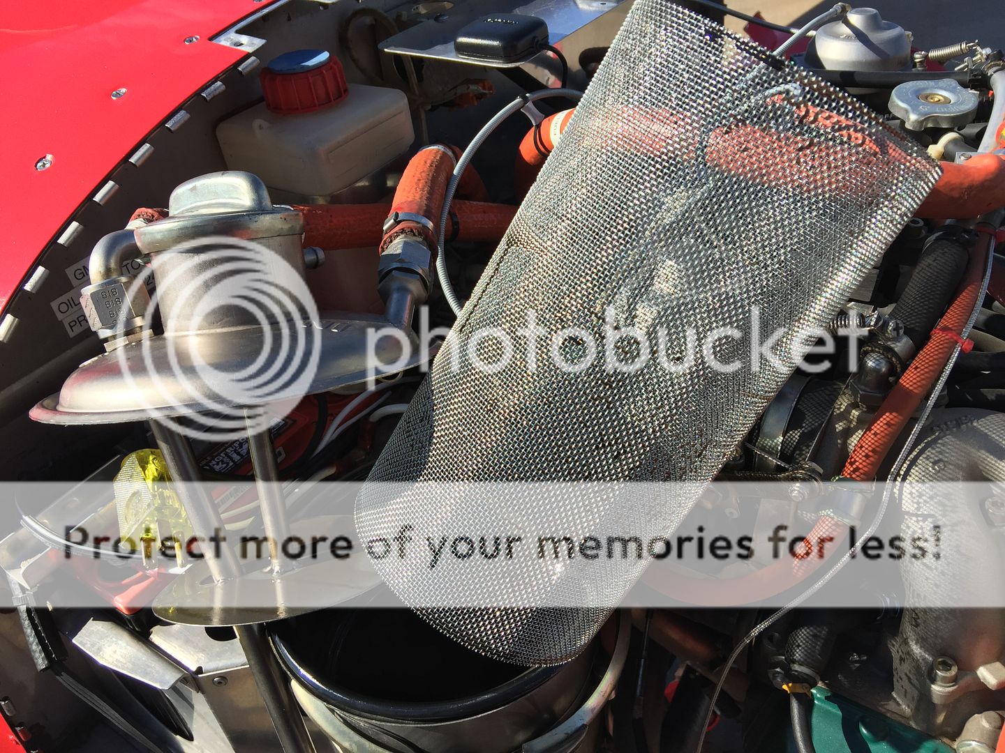

Just cleaned my oil tank for the first time in 788 hours. I've run 98% unleaded auto fuel. Looked great with a small amount of sludge in the very bottom of the tank. Won't be doing it again any time soon.
John
RV12 N1212K

Hi John,
Nice job.
If using unleaded fuel and doing the appropriate oil changes then tanks tend to remain quite clean. Using 100LL all the time and regular extended oil change intervals can certainly cause build up down in the bottom and on the screen. Yours looks like I would expect with unleaded fuel use and good maint. practices.

Yes! After watching those youtube videos I got motivated to clean the tank.
Now that I've done it all the mystery has gone out of the procedure. I did order a new o-ring that goes around the rim since mine hasent be done for some time. that O-ring is a little expensive, $32.00. I will probably do it every 200 hrs or so. I like a clean engine.
