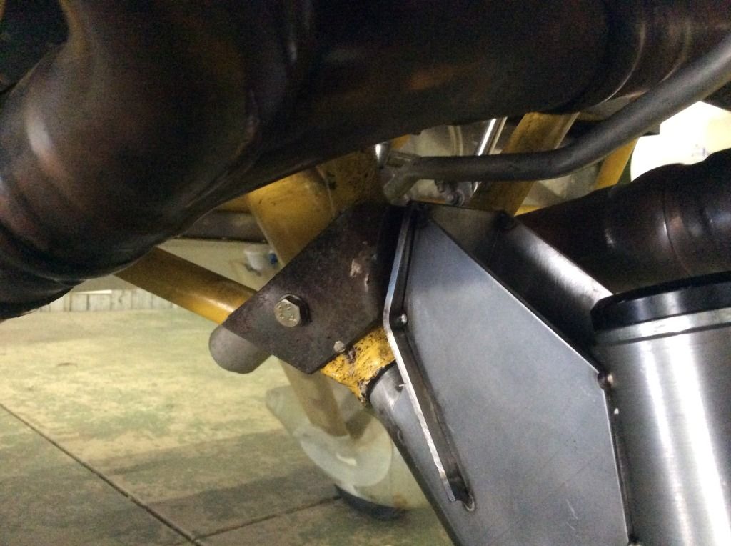

Can you post a photo of the attachment to the motor mount area?

This is a picture of a early version that was not used but does show the attachment.
