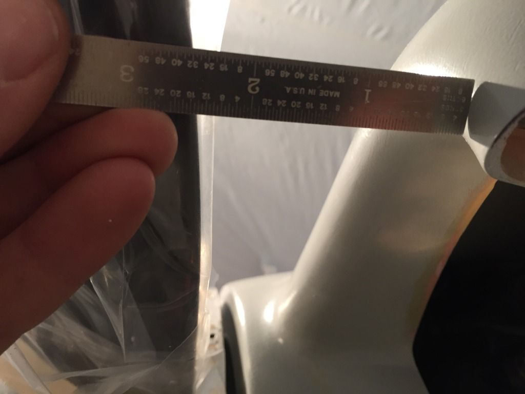

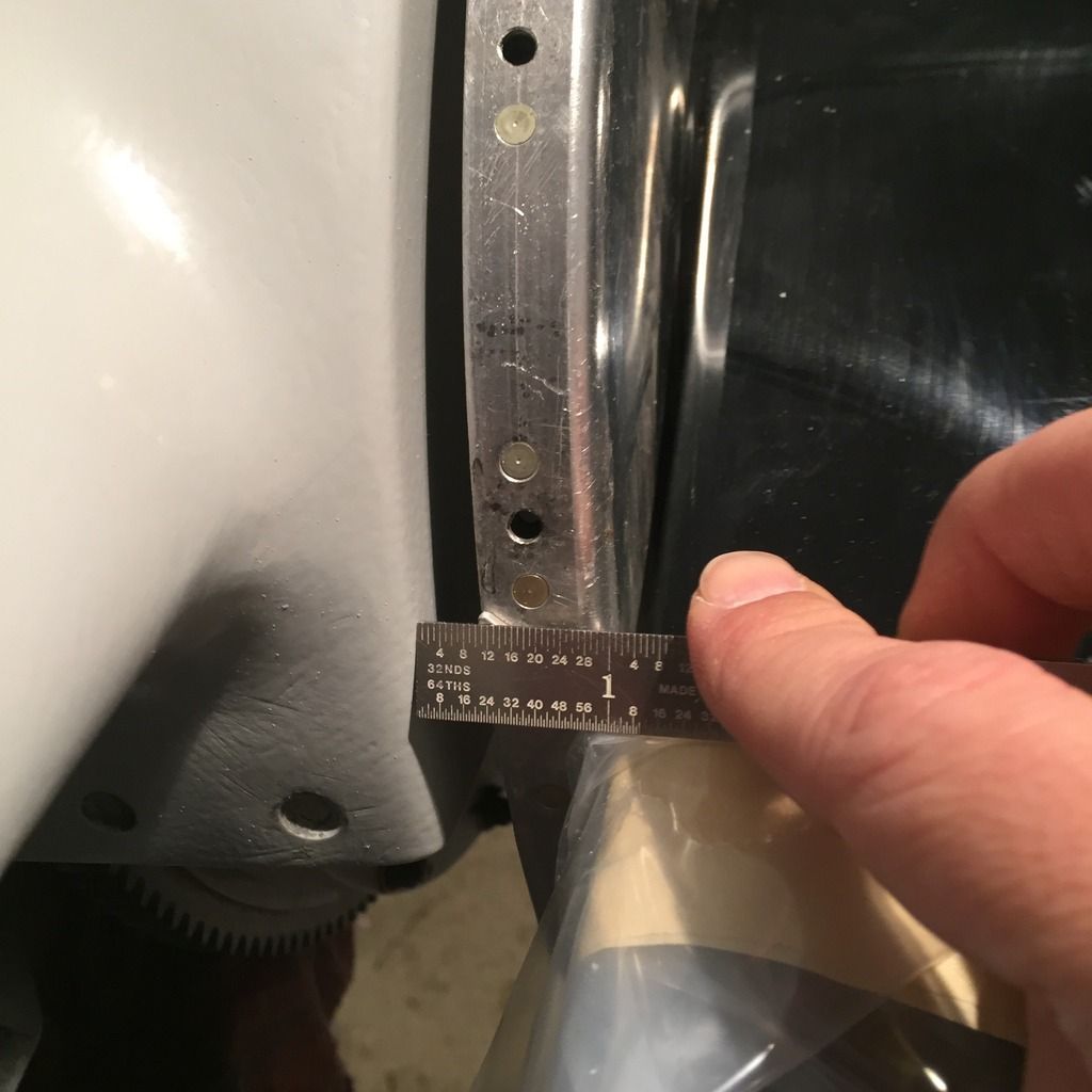

As long as I measured correctly it should work, I was surprised how far forward I was able to bring the inlets. I temporarily mounted the prop to check clearances, the inboard blade trailing edge is about 1 1/8 from the flat face of the cowling behind the spinner.
More clearance outboard due to the blade shape of the Catto.

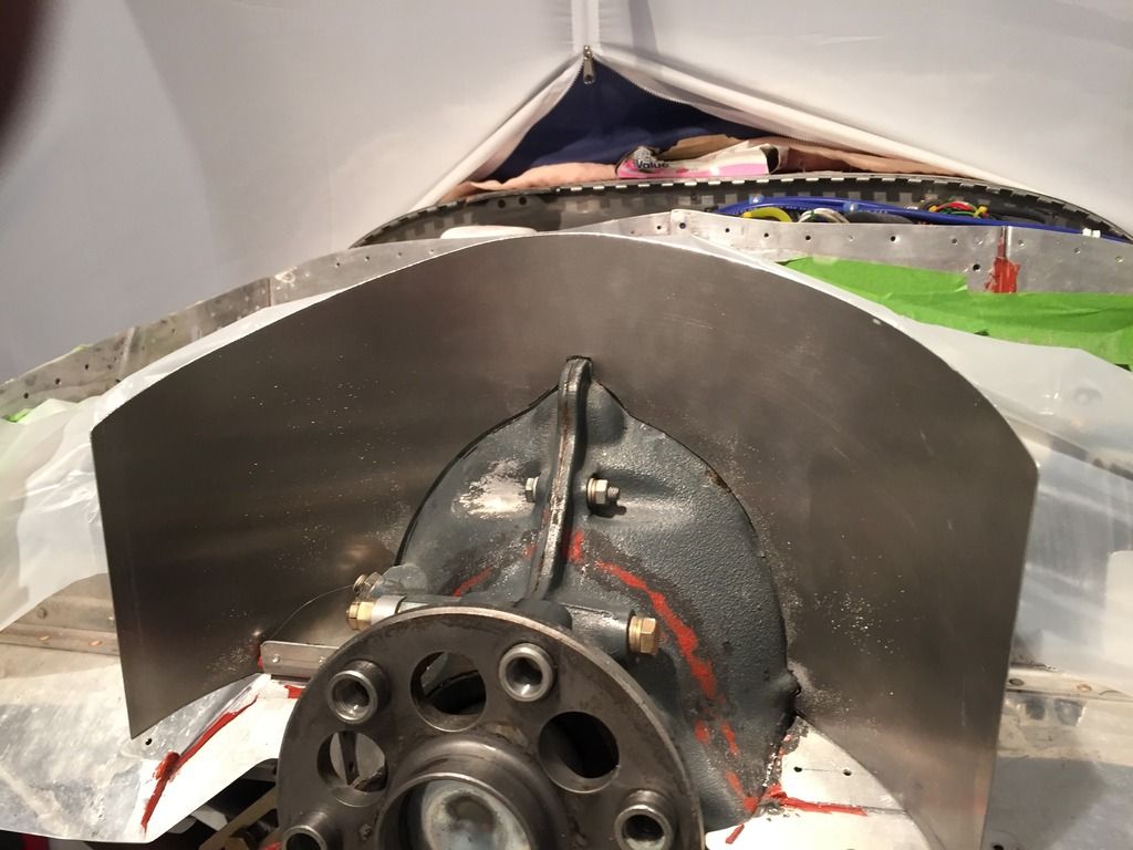

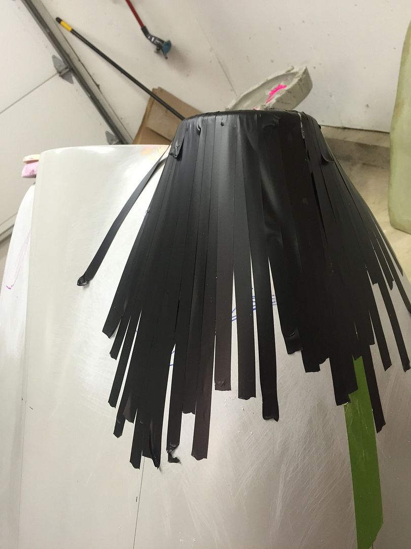

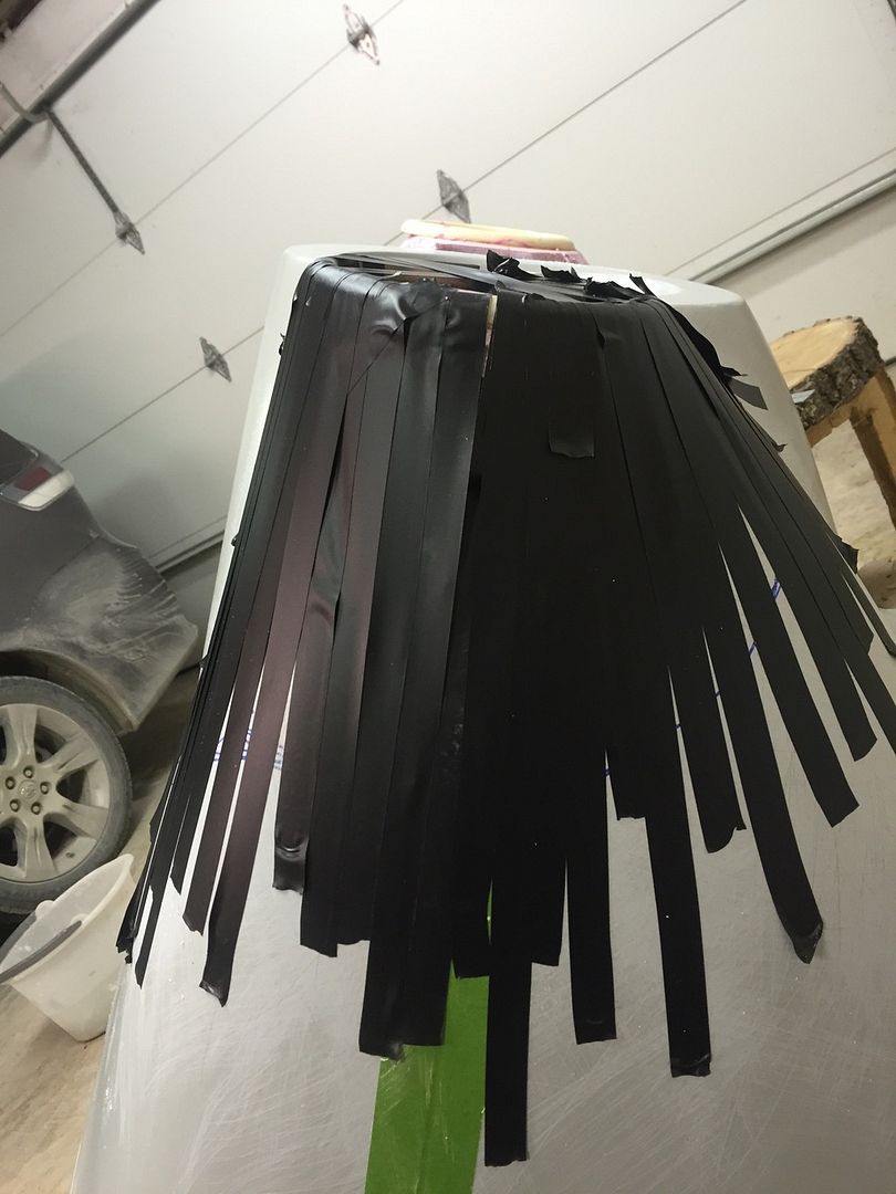

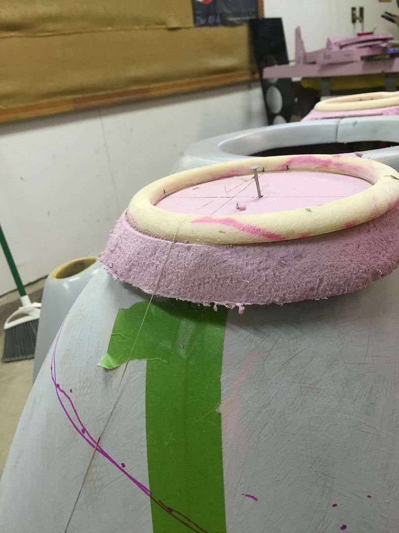

Good news is the prop flange bushing that I staked and used red loctite on seems to be holding, I torqued a socket over the bushing to 50 ft/lbs twice as a crude test.
Bad news is I didn't care for the way I originally blended the rings into the front of the cowl. I basically ran dental floss over the front of the ring and back along the cowl to find the intersection where blended in ring met cowling, the results were to sharp/square/pointy for my liking and didn't jive with the rest of the cowling. I sanded all the foam back off and ran some more tape to try to come up with a more pleasing shape, back to the mind rambling drawing board.
I also made a little progress on my center baffling piece, I made my first real airplane part with my ancient slip roll. You can see the RTV line where the stock baffling was, I tried to extend it back for a longer diffuser. Now to dream up some attach brackets and electronic ignition flywheel sensor wiring armor. I read someone else's thread on protecting the wiring, mine could be better.

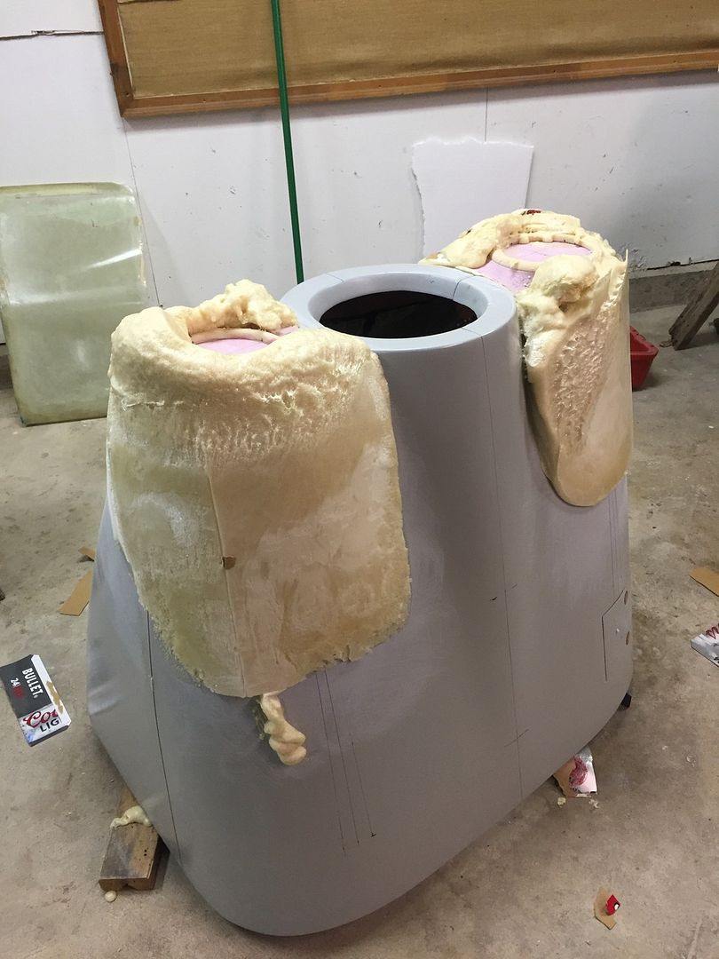

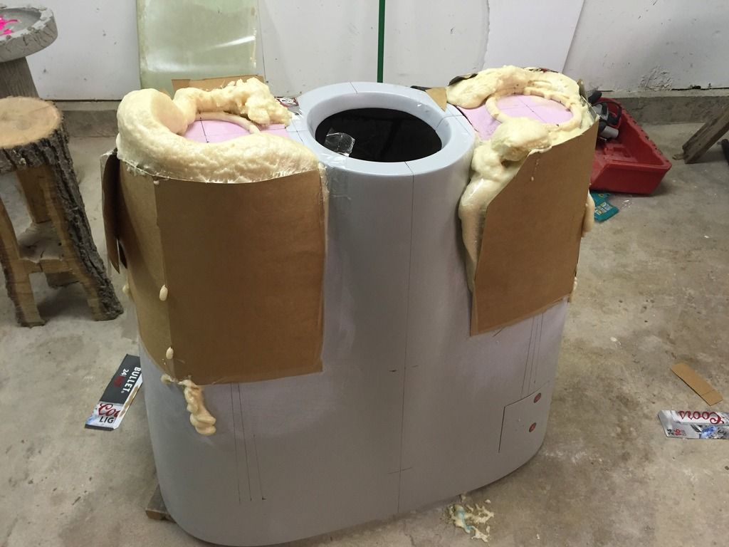

I made a center line down the cowl, it doesn't look right but the inside lines are parallel to the center line. My eye likes the lines pointing toward the outside.
In my first go I used the wife's hot glue gun to glue foam to the cowl, It OK but as the foam was sanded down the little parts without any glue would lift and flex. I think the hot glue gun would still work good to hold blocks of foam together as long as the glue didn't protrude into the area being sanded.
I cut up a Coors Light box and a Dr. Pepper box and used packing tape to stick it on the cowling inside out to hold my pour foam. The Coors Light box was slightly waxier/slicker than the Dr. Pepper and released from the foam just fine, I waxed one of them but couldn't tell the difference when I pulled them off. The pour foam is something else, mix it as fast as you can and it's growing in 20-30 seconds! It's ready to sand in about 30 minutes, too bad I have to go to work!
