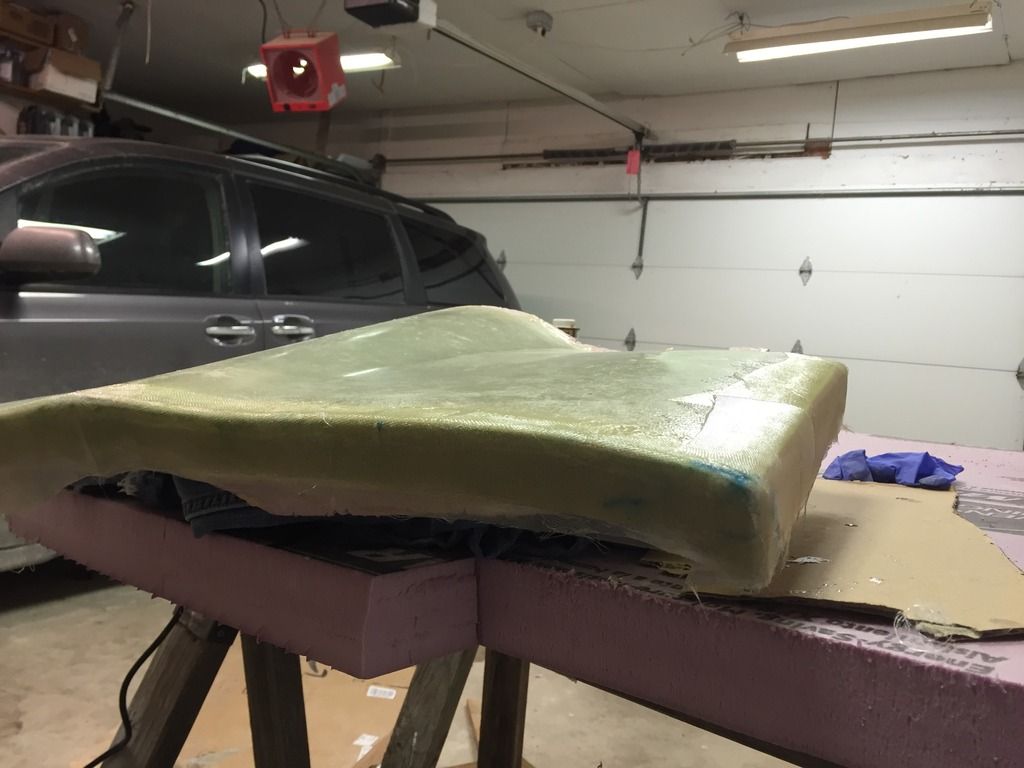

Unfortunately BillL was right, there is a bit of a twist in the baffling. Seems the right front of the baffling is 1/4-3/8 inch lower than the left front. I'm sanding off the foam I glued to the fiberglass plenum and gluing foam to the baffling instead.

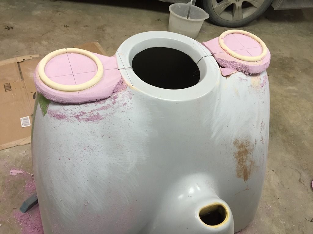

I think I've finalized my inlet shape and size. I originally planned on using the existing inlets, but to better my odds of more cooling I decided to:
-make the inlet area larger
-move the inlets outboard
-move the inlets forward
-use round inlets

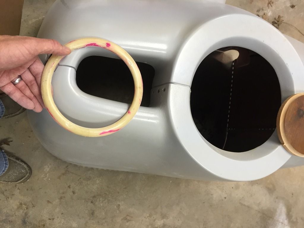

I ended up with 5.75 ID per inlet with 25.97 sq in versus my stock size of 21.29 sq in, SJ large rings have 16.8 sq in per inlet. Being fixed pitch I generally climb out at 130 knts as a compromise between horsepower, climb rate and cooling. At 130 knts my stock Vi/Vo should be .54, with the new larger inlets it will be .45. At 90 knts the stock Vi/Vo should be .77 with the new larger inlets at .65.
I used a 7/16 outer lip and a 3/16 raduis inner lip for the ring I plan on bonding to the front of the cowl. I routed a 7/8 core box into some HDPE then routed the middle of the groove out.
I routed out another disk to fit the hole and then used a 3/8 core box bit to make the inside radius. I used a finish nailer to tack everything to the bench.
The new ring with the smaller inner radius next to the full 7/8 diameter ring I made first, the OD of the smaller ring is .75 inch less.
The 3/4 inch smaller outside diameter of the new ring appears to be easier to blend into the existing cowl, just my uneducated opinion.

2. The 6" diameter on the inner lip may seem too big, but if you do the math it will give you just about the same area (28 sq. in. each side) as the standard Van's cowl inlet (25 sq. in. each side).
Michael,
Just curious if the inlet area quoted was from a smooth horizontal induction Van's Cowl. I found my vertical induction on cowl inlets were considerably smaller than a friends RV7 with the smooth bottom horizontal induction cowl. Just curious if all the smooth bottom cowls have a larger inlet area than the vertical induction. I did some glassing to get the inlets to match up while fitting my cowl, I think I inadvertently decreased my inlet area while doing this.

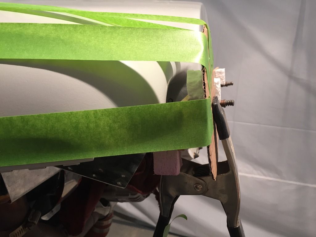

I mounted the prop to find my clearance from the back of the prop blade to the front of the inlets, since the spinner portion of the cowl is flat and equidistance from the prop I used it as a reference.
The inboard right side is 1 1/8 inch aft of the prop blade, the left side is 1 3/32 inches. The outboard side is harder to measure accurately due to the blade sweep and lip of the inlet but the left outboard side is about 15/32 further aft than the right outboard side.
I mounted a yard stick to the split line of the cowl and hot-glued some foam to represent the closest point of the rear of the prop blades. I marked center lines on the round cardboard with some vertical tick marks to play with different locations, I also made some marks on the spinner portion of the cowl for outboard/inboard measurements.
This moves the inlet out quite a bit from the original location, I'm shooting for 3/8 inch aft the prop blades on the inboard side of the inlet.

While we were waiting for the cowl to dry my oldest daughter and I made some templates for the flanges of the plenum. After gluing the plenum top to the foam on the engine baffling I sanded the edges down to make up for the width of the fiberglass, we'll see how it fits.

When I originally fitted the cowling I used a 3/16 inch gap between the spinner and the cowling, I'm using the flat face of the cowling behind the spinner as my reference plane. I used a 1/4 inch piece of Masonite over the flat spinner area to give me the proper height, I used a flat piece of oak with some sandpaper glued to it to sand the foam down. I used an 1/8 inch piece of cardboard to further cut down the right side which was slightly closer to the prop. The
It left me with about 11/16 gap between the flat spinner area of the cowling and the front of the rings, the left side foam height is 3/8 inch higher than the right side. The aft edge of the prop is about 1 1/8 forward of the flat spinner area of the cowling giving me about 1/4-3/8 inch clearance between the prop and inlet rings....I hope.
Inlet rings epoxied in place.
