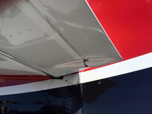

So, just back from vacation. As someone said here on the thread, NEVER use indicated airspeed to compare performance. It is utterly useless, unless you have enough data to compute the true airspeed. As you can see in my pics, the true airspeed is in ktas. I use knots as that is the standard since the mid 70's. Anyone who wants to use mph, feel free to do so, but that is not the standard unit of measure for aircraft. Enough about that.
Someone asked about the aileron fences. Since both the flaps and ailerons are slightly reflexed, the current spanloading now has a slight peak at the wingtip, as it is operating at a slightly higher aoa. In order to avoid vortices and extra drag, I am "blocking" the flow from the lower surface flowing to the upper surface, and thus minimizing drag. Ideally, I would at some point modify the wingtip with reflex as well.
As far as an exhaust fairing, I have one as well, not used for this test though. I will do some modifications to it, and then I will try it again. I have already a nice ramp on the inside of the cowling -exit, so it might not do that much for performance. I also have an adjustable cowl flap, which make more of a difference.
Next goal is to get to 173-175ktas, which will be very tough...

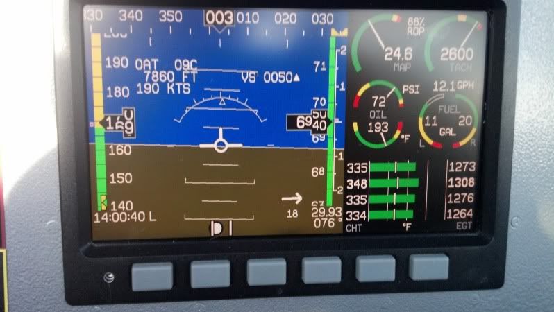

mines a 7 not a 7A, but I cruise 178KTAS at 8.5gph 2440rpm around 8500'. normally though I cruise above 9500 to 12500 most trips. I see 178-180ktas burning 8.2gph 2380-2420rpm. If I want to burn more, I'll pushing the mixture to the ROP, where 9.5gph is about 182ktas.<---Not positive on these numbers since i don't spend much time there.
Thanks. Were you able to isolate the effects of the aileron fence by themselves?
What was your density altitude for those numbers? What engine do you have (hp)? I assume that these numbers are LOP?
I went back and found couple pics of my panel with the numbers. DA varies. also note the MP gage reads high by 0.4 or something like that. and I have a airspeed error of ~2kts at this speed. I run a Lyco IO-360 parallel valve engine, 9:1 pistons, superior forward sump, AFP injection w/RamAir and Pmags, Vetterman 4pipe. swinging a WW200RV prop, Sam James long cowl w/plenum.
The cruise fuel burn in this pic is higher than i am used to seeing, can't recall why.

Default Fences
No I wasn't able to isolate the effect of the fences. I added up a lot of things for this test (which I shouldn't have) so it is difficult to say. It should help, if nothing else, with better aileron effectiveness and lower induced drag. Induced drag is low at high speed, so the effect would be slightly higher climb, which I can not confirm yet.
