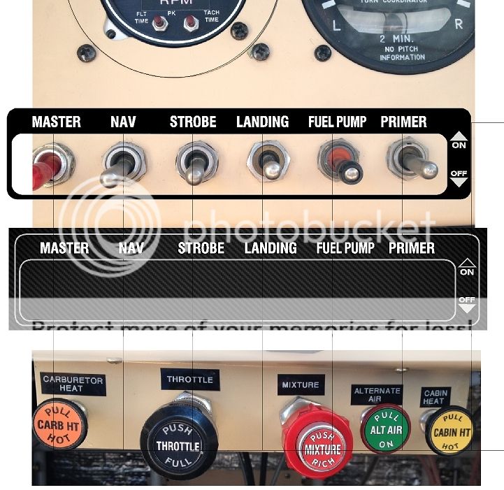

flyboy1963's Avatar
Posts: 2,416
Default +1 for clear printed labels...
I can't believe how good the clear labels have stood up on my panel.
but if you want a fancier look, not that hard to have a shop print you a bunch all at once, then you can control the spacing and size of the lettering to really suit your needs.
I was messing around with a new switch panel like I've seen on some of the 'fancy' panels you see on VAF!
a good example of visibility; you can't really see the throttle labels if you are over 6' tall, so having them on the actual knobs is much better.
Perry Y.
RV-9a - SOLD!....
Lake Country, BC

Just out of curiousity...why the need for labels on the panel if they're already labeled on the knobs??
