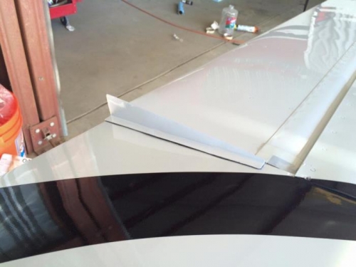

Finally, I broke 170ktas with my 160hp 7A!!
The changes since last time was: vhf and vor antenna fairings, ailerons reflexed to match the flaps (-2deg), elevator trim rod fairings, aileron fences!
170ktas at 75% and 160ktas at 65%!
This is a 2-3ktas increase since last change.
So far I have a 12.7% drag reduction since phase 1. Flat plat drag has come done from 2.36sqft to 2.06sqft.

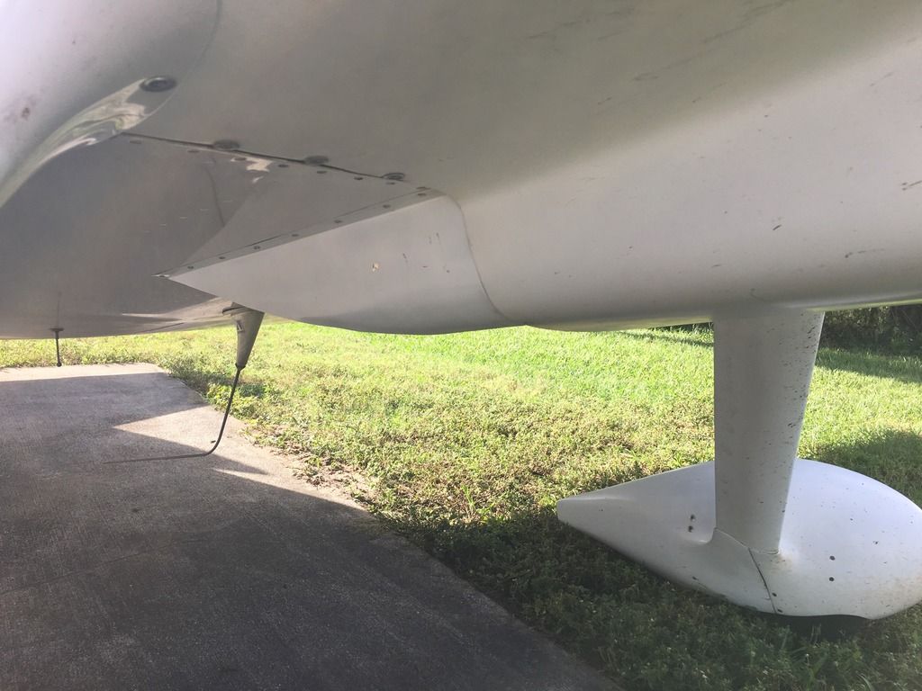

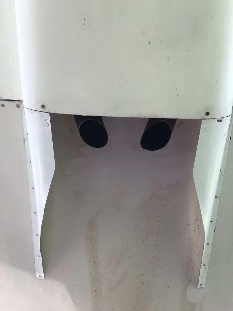

I sold my 160hp RV8A recently (based on a grass strip with seasonal terrain problems). I kept the plane very light with tight clearances and a number of speed mods. I typically flew at 200mph at 10,500 (2600rpm) when travelling. 205mph at 2700rpm. I think the biggest gains were from the following mods in order of benefit: 1. Cooling exit fairing 2. Shortened wingtips (only works for a very light plane). 3. Faired fuel drains and Xponder antenna (I combined these because I used the same process for all 3). 4. Flush tail strobe. 5. Deleted the external canopy handle.
The flush tail strobe was done by forming a 'window' out of lexan with the same shape as the bottom rudder fairing. I then cut away that part of the fairing and replaced it with the window. The LED strobe light was mounted inside.
The cooling exit fairing was copied from the ones seen on this forum, but made in 3 pieces. That made it a lot easier to form it. While on the subject of exit fairings,,, I made one for the RV6 I bought and a ramp inside to direct airflow and picked up 6mph.
Photos please..

What are the aileron fences doing (in theory)?

Cooling exit fairing. Hlangebfo, do you have chart of it (I fly RV6A with Weterman cross flow exhaust).

Also, I noticed in the aileron fence picture that you seem to have done something over the pushrod attachment...

Here's a couple of pics ("I hope" says the caveman) this is a little different than what I did on the RV8A. The 6 exhaust is angled much more sharply down, so no center piece. The ramp that guides the air out of the cowl is likely as responsible as the 'flow straightener', but I'm too lazy to take the cowl of just to get a pic. Sorry about the dirty bottom... been doing a little acro.
[IMG][/IMG]

The other pic that I thought I posted...
