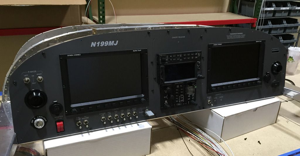

My wife and I decided that when we were going to build our 14A that we would not do the panel by ourselves. I wanted to A: live long enough to fly the plane, B: have a system that worked without bugs from the first flight forward. That being said, we met with Stein and part of his crew at Osh and were very impressed with their presentation. We came home and went online to Youtube and viewed some of Steins videos and were convinced that he would be the right choice to build our panel. I must also add that Rob Hickman also has a very good case for prebuilt panels for RV's but we wanted more of a custom unit and finally decided on Steinair as our builder. I have to say that up to this point in time we are thoroughly impressed with Steins company, staff and attention to detail. We spent a month going back and forth with panel iterations and it took 14 trys to come up with the final design. All communication with Steinair has been immediate and all is proceeding as promised. I think that we will have our panel before we get our FWF kit. Moneywise, what we decided on is way over what we originally planned on but I know that we will have a panel that will be a work of art and will work properly when it is installed in the plane. I don't want to be chasing squawks on a new aircraft. I know that most builders are on a budget but from my reading on the forums, no almost no one ends up spending what they originally budgeted to build their dream aircraft. Enclosed is a pic of our panel as of this week. I will of course post it again when it is installed on the plane and operational. I will be happy to discuss our design and thoughts that went into building with anyone that is interested. woodmanrog@gmail.com Ho, Ho, Ho and to all a good night.

Looks good. Those top screw holes have to be countersunk. As the canopy comes down, it will hit those screws.
This is correct.
