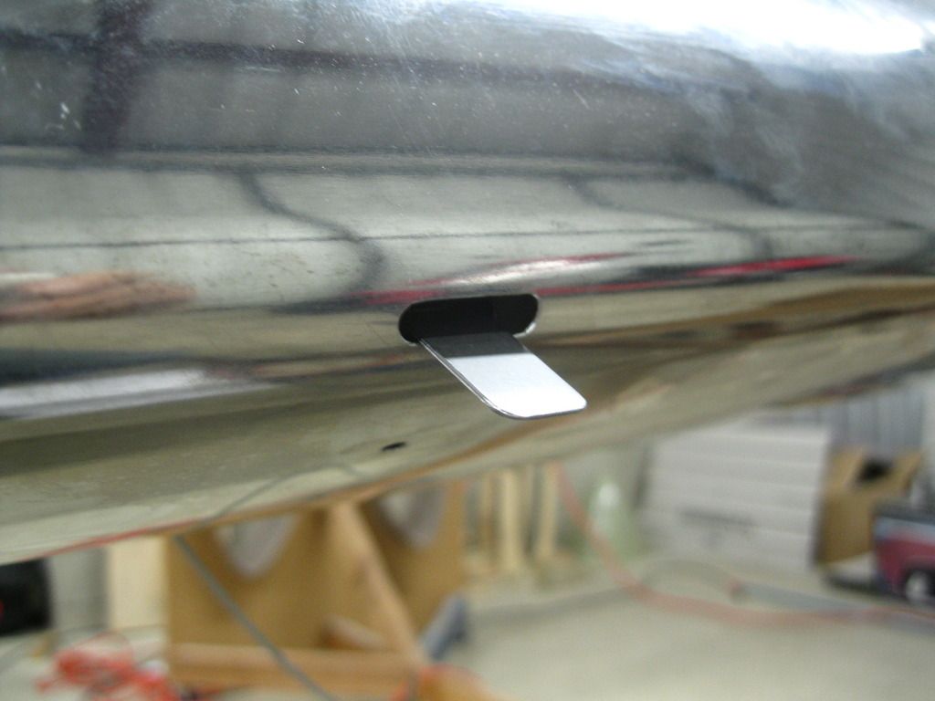

My EFIS has an AOA feature, but I like the good ol' fashioned stall warning too, with a really loud buzzer in the cockpit. So that's been installed, which is nice. Got that going for me. :roll eyes:
