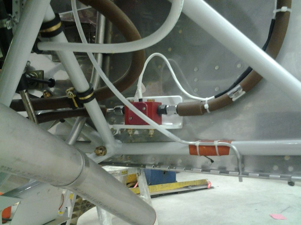

Default Here's where I put my Red Cube on my -8.
Awaiting new hose from Tom to run between Cube and spider.
Warning: untested. Still building.
Your chosen location is going to be the high point of the installation. Just what EI's installation guidelines say to avoid.

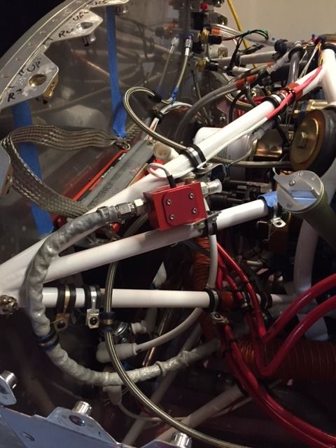

As the op I thought I would share where the cube ended up.
Tom made a short hose with a 45 on one end to go to the servo (rear outlet), keeping the cube as low as possible.

  #38
Old 12-09-2015, 09:48 PM
rockwoodrv9 rockwoodrv9 is online now
Join Date: Dec 2011
Posts: 2,645
Default Perfect!
Jared, Thanks for the picture. That is exactly what I am going to do. Im even going to paint it white as a tribute to you! Ha!
rockwoodrv9a
Williamston MI
O-320 D2A
Awaiting DAR Inspection

Location: Fort Mill, South Carolina
Posts: 345
Actually, it's still uphill to the spider from there, per my installation instructions. I Googled for more info, and it looks like there are "old" Red Cubes, and "New & Improved" Red Cubes. I found a 25+ page set of installation instructions on line that I think pertain to the older model. My Red Cube came with a 2 page install sheet, that says: "…the fuel line on the outlet port should not drop down after exiting the transducer."
Pretty sure I complied with that, but will double check…especially in a level flight attitude.
There was no mention of bubble-trapping loops in my installation, but I DID see references to that in what I think was the "old" manual.
Thanks for keeping me honest. Love the feedback on this site.
