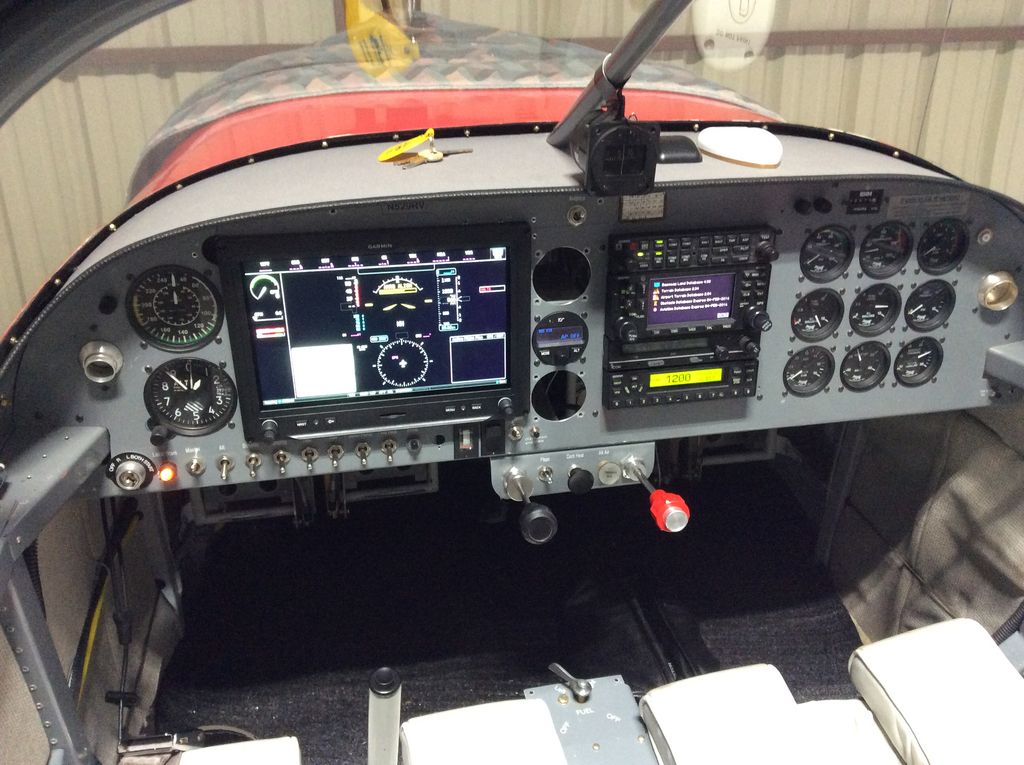

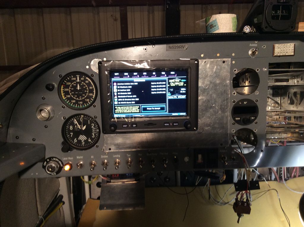

I flew up to Airlake and picked up a GDU 460 and luckily it fit nearly perfectly into my panel where I had the 450. In some of my pictures above you can see the patch panel that came out to fit the larger screen.
GDU 450 small display with patch to allow large display.
My advice to anyone trying to decide between the small or large displays is get the big one! There are too many things that the small screen just does differently that the large screen does better.
One easy example, when you touch the autopilot control it pops up the full AP screen. On the small display, it covers up the PFD, on the large display, it splits the display and you still have a completely usable PFD with AP controls next to that.
My plan now is to move the rest of my engine probes over to the G3X EIS and then mount the smaller display where my current round gauges are.
I also got to see the MINI X while at SteinAir, it looked nice so I will be saving for that as my backup.

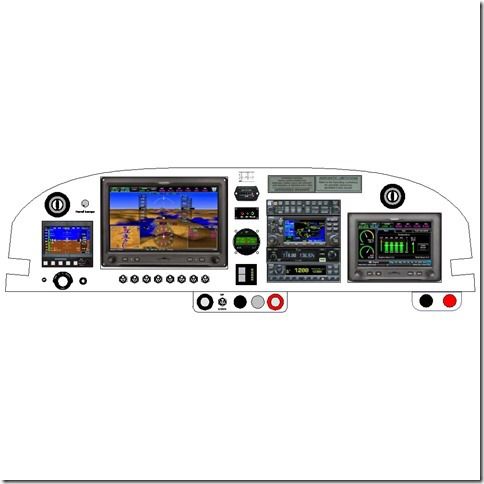

Here is a preliminary layout for my upgrade.
Any changes or suggestions are welcome.
If you have a similar equipment layout I would love to see it.
Here is the panel now with the single large g3x.
And the first preliminary layout.
