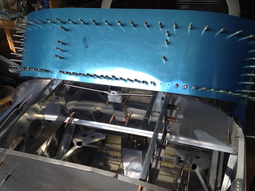

After struggling with this for over a week, I finally got the forward tip-up canopy frame to fit nicely and got the hinges drilled. Thanks for everyone's help, suggestions and encouragement on this forum

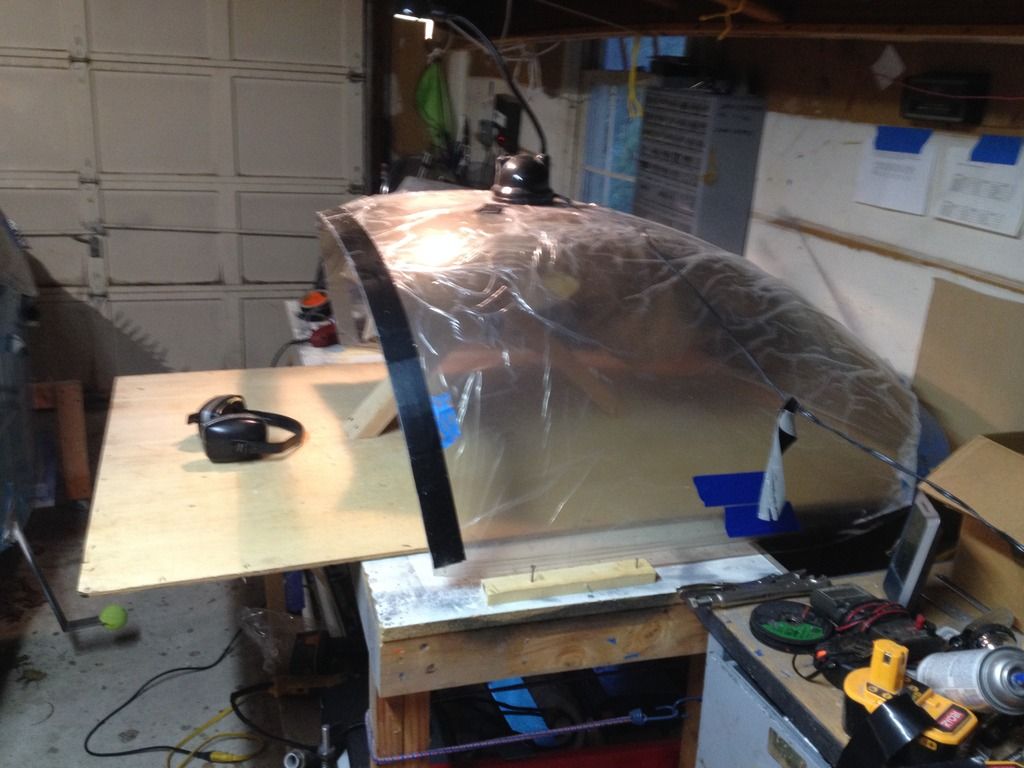

Made the big cut today using an oscillating saw. Great control and very small curf. Onto the sitkaflex!!

I did the big cut about a year ago. I used an oscillating saw as well. I found I had to rotate the blade as to clear the cut material while cutting. The finish was near perfect and needed very little dressing. I like using the oscillating saw because the blade only moves about 3/16". Never bound up like a cut off wheel could. The whole process took a bit longer than a cut off wheel but, I was not (and who is?) in a hurry to finish the cut.
