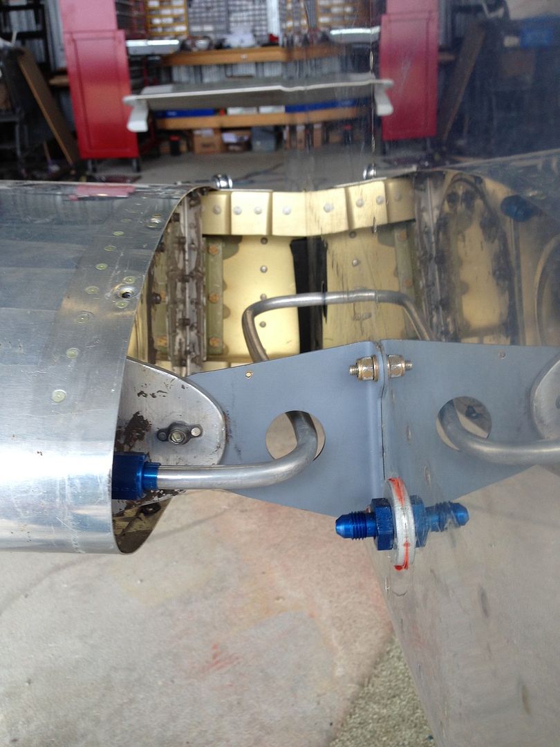

Whew, new fuel lines from the tanks to the gascolator complete. I used approximately 24 feet of 5052 to make roughly 6 feet of fuel lines. Leak check, ground run and an hour flight were leak free.
I wasn't able to appropriately bend the 5052 as a 1 piece line like I could the 3003 so I used a union and 2 pieced it. I went back and forth between the 5052 and the extra joint or 1 piece of 3003. I found 3 1/2 turns of my Rigid flaring tool gave me good consistent flares and 75 inch/lbs with a crows foot was about 3/4-1 flat after my "finger tight."

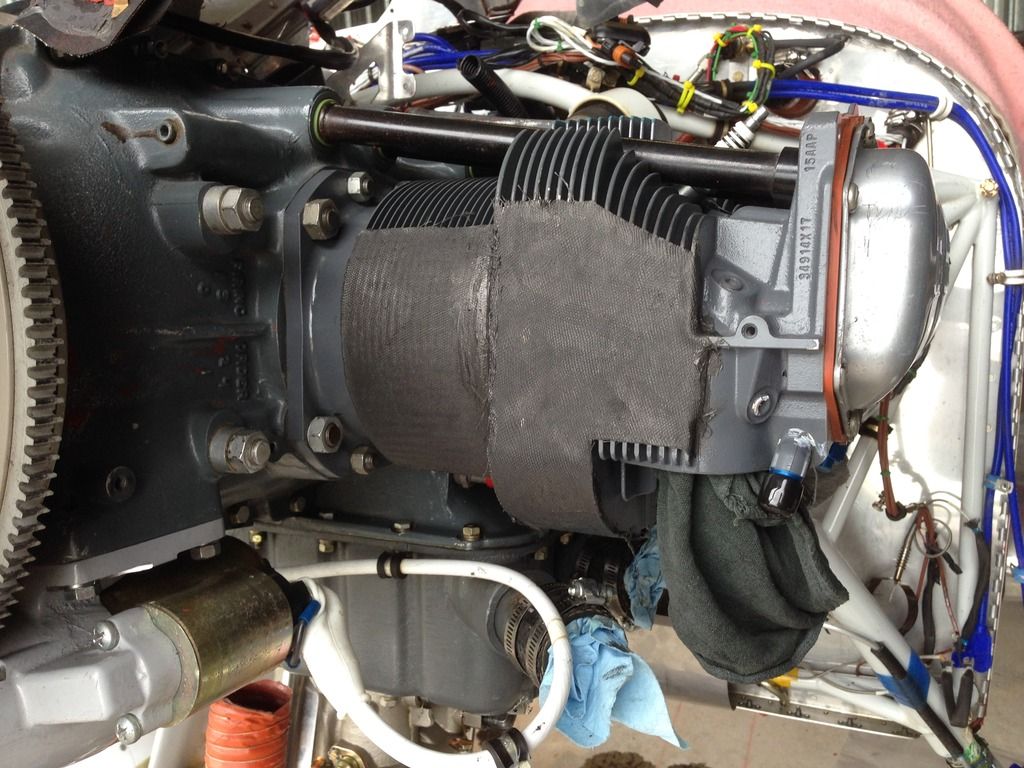

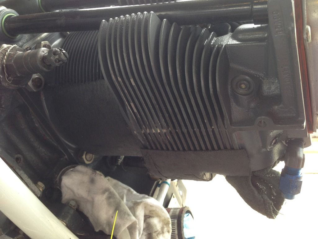

Cylinders torqued per the Lycoming Overhaul Manual and Service Instruction 1029D.
When I did a baffle repair several months ago I noticed the lower cooling fins were eating into the lower baffles. I made "pads" out of the Van's black baffle material and glued them to the lower baffle wraps. There was more wear than I expected on the black baffle material on the lower wraps, I'm going to copy DanH's work from here (post 39):
http://www.vansairforce.com/communit...fle+mod&page=4
As expected my composite workmanship still has a ways to go, on a good note there was no mess to speak of. The front cylinders have always been cooler than the rear cylinders, I extended the baffle wrap a little higher on the front cylinders.
Between the heads I used short pieces of the Ultra Black infused 9 Oz fiberglass, than I ran a bead of sealant between the 2 pieces from underneath. I also used Ultra Black along the edges of the wraps that I could get to.
I have the oil cooler mounted behind #4, I made the wrap a little longer slightly overlying the top of the cylinder. I wanted to see if this would help keep the air in the cylinder fins instead of exiting through the cooler, at least that's my intent.
On the backside of #3 I made a small piece of wrap that started slightly below the minimal cooling fin depth area. Previously had a washer between the cylinder and the baffling, I may add a small bump to increase airflow.
Remember, the forward side of #2 has the same "no fin depth" issue as the back side of #3.
Don't forget to seal between the outside of the glass wrap and the inside of the aluminum wrap.
