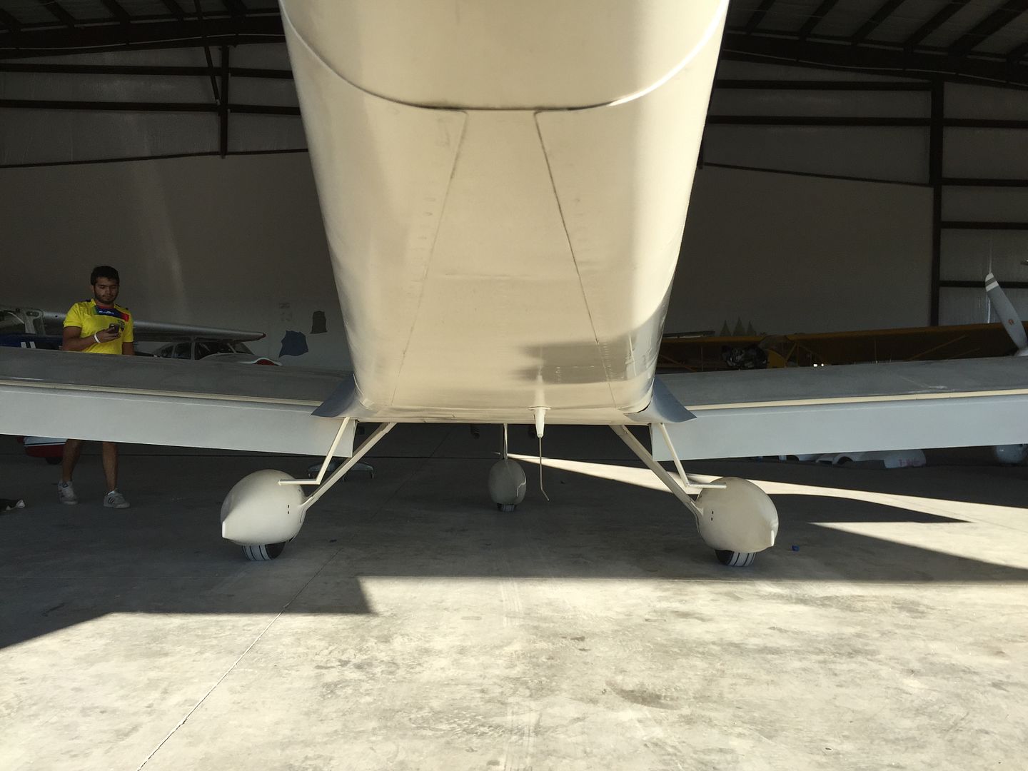

I know this is an old thread and I should probably just start a new one, but I want people to know the contrary views when looking at this, even though testin has shown a speed improvement. As I mentioned in my previous post, these were designed by an aeronautical engineer and they have shown a speed improvement on all installations.
We installed a set of fairings today and should have some independent speed results in the next week or so.
Attached are pictures of the new installation. We have these in stock and are offering them now for $2,000 installed (installation options vary, but his would be the lower cost option included in this price). We can install them in an afternoon. Of course, paint is not included, but the fairings are filled and primed, so a tiny bit of prep will get them ready for paint. No pinholes. The added weight should be about 6 lbs, again, depending on the installation format.
Jesse Saint

Along the inboard end of the wing it's pretty much just the same screws as would hold the standard fairing. Along the fuse side skins the options are rivets (fastest), rivnuts (relatively fast, but the possibility of the rivnut spinning) or nutplates (the best method if easy removal is desired, but much more work to get all of the nutplates installed). Then you can choose the size of the rivets or screws. You also need to decide the spacing of the fasteners.
The rivet method works really well and inspection of the wing root can be done from the bottom, so it would not be necessary to remove them unless perhaps in the case of n ding to remove a fuel tank or the whole wing. The rivets would then need to be drilled out. In our installation today we used CS4-4 rivets and the normal #8 screws on the wing.
