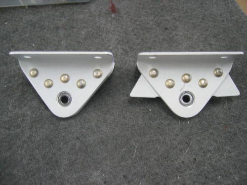

Hi,
I'm a new builder with a stupid question... What size and type of rivet should I use for the vertical stabilizer upper and lower hinge assemblies?
More importantly, how do I figure this out from the plans?
This is the very first assembly in the empenage kit and I'm already stuck. This could be a long 900 hrs!
Thanks in advance,
Harry

All hardware is called out in the plans. Read section 5 of the plans to understand terminology. Rivets are called out in the plans by the rivet ID such as "LP-4-3 12 places" and usually has an arrow pointing to the area being referenced. Reading section 5 is very important along with the other book that came with the kit. I think it's called aircraft hardware and construction or something similar. It's a paperback book.

Page 06-02 figure 3 calls for AN470AD4-7 rivets
Read chapter 5, some airplane construction books or try to find help for the first steps. Enjoy it!
Btw I messed up two hinge sets and a vertical stab spar on the first day ;-)

Might be worth assembling the Vans toolbox or practice kit before tackling the real thing. It's a good way to learn how to read the plans, prep parts, set rivets etc.

Parts that you plan to install on your airplane should not be used for learning a process. Doing so induces a high probability of a lot of replacement parts being purchased.
In simple terms, if you pick up a tool to do a process that you have not done previously (and become somewhat skilled at doing it), you should be doing that process on something else first for practice.
I also echo reading Chapter 5.... multiple times. Particularly the first 10 pages with the point you are at in your build.
If after reading through it a few times and doing a bit of practicing on something other than your kit parts, you aren't clear about something, ask questions.
